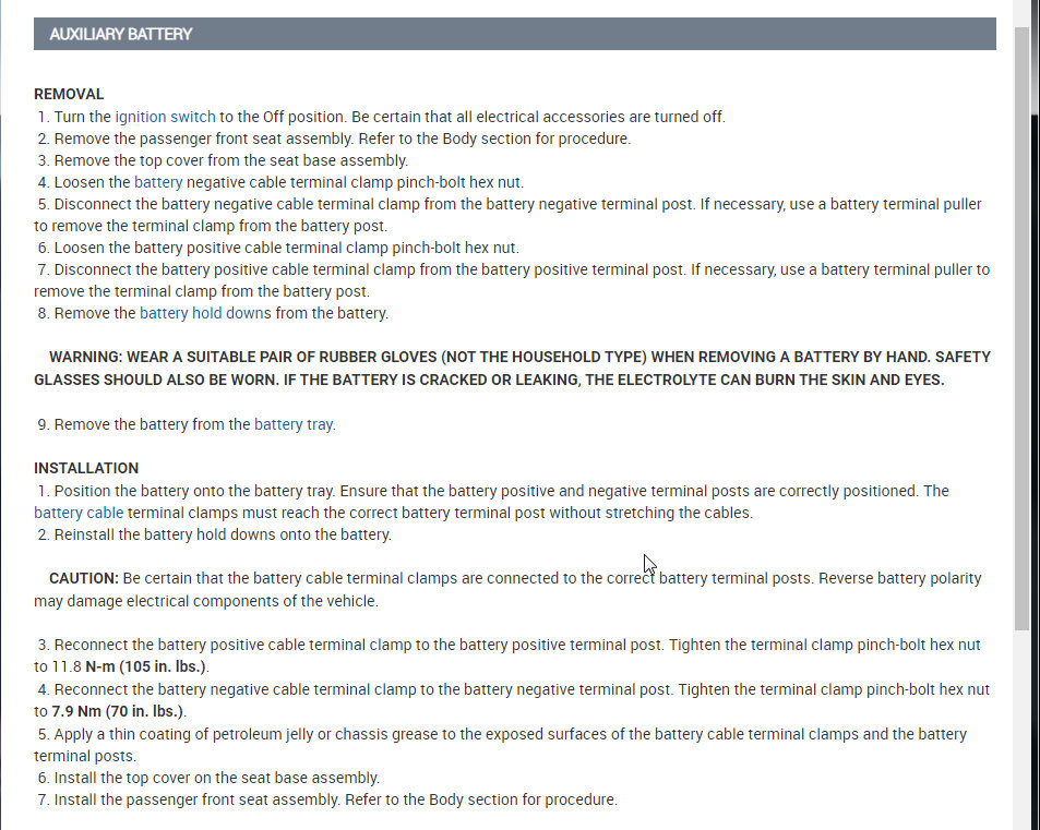

Hello, as above, I would like to remove the starter battery but it looks complicated (lots of connections etc., on the positive terminal) and I can't find any decent information or instructions online. Also, I'm not sure whether it may damage any vehicle electrics etc? Vehicle listed above is a JTD.
Thanks for any help, Stuart.

We don't have a manual on this vehicle but it is similar to a Sprinter so i attached the instruction on the aux battery for that vehicle.
However, they normally have one nut that you can loosen and that will take the entire battery terminal off. So if you can get a picture of what yours looks like, I am sure we can point it out and that will help you get it off.
