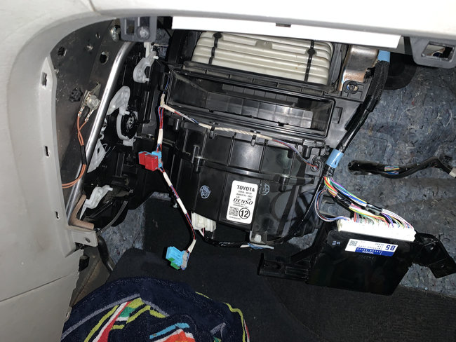

Trying to replace a blend door actuator. Have the lower glove box door off and have removed three screws from the assembly which holds the two actuators (recirculation and hot/cold). The assembly is loose, but something is still holding it in place. Is there a clip or another screw? I'm trying not to break anything...
Dec 14, 2019 at 3:11 AM
No. It is just a plastic gear on the inside. A lot of times these strip and will hold on to the door and feel like it doesn't want to come out but if you have the screws out then it should come out. There are four holes for screws but they normally only have 3 so I would just check to make sure there isn't another one and then just start wiggling it and it should come out.
Dec 14, 2019 at 11:27 AM
VA2019

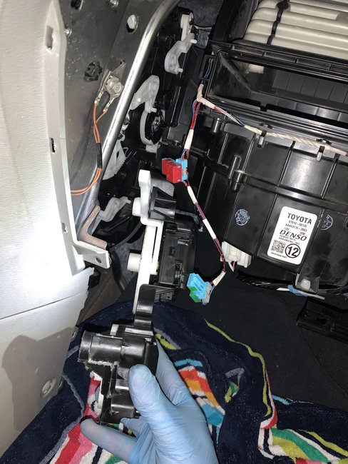

Thank you, KASEKENNY1! You were right. Got it out and got the actuator replaced. Any advice for getting the assembly back in? 1) There is not much space to work with and it seems to be binding on something right before the gear shaft seats. 2) Should the various levers on the car that the actuators link to be in certain positions when the assembly is replaced or will they automatically get aligned once it is in and powered up? I'm sure they got moved as I was wiggling the assembly out, so not sure what position they were in originally. I did turn off the HVAC and I don't believe the defrost was on. Thanks again.

Okay. You can do this a couple ways. If you have a scan tool to calibrate the actuator then just put it in and calibrate it. If you don't which most do not, plug the actuator in before installing it and set the temperature to full cold or full hot. This will but the actuator in this position and then you can manually move the door to the same position and then install the actuator. If you are not sure which position the door needs to be in, start the engine and manually move the door so that the air coming out is matching the setting.

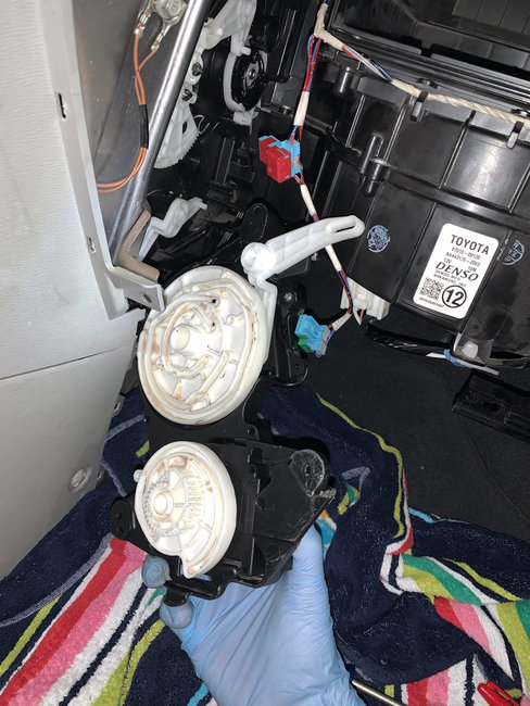

Thanks KASEKENNY1. I got it back together and everything is working as it should. I took the top wheel off the assembly and seated it first, then put in the assembly, seating the shaft from the top actuator into the wheel. This approach had two advantages. First, it gave me the extra space I needed to get the assembly in the right position. Second, it let me easily get the wheel aligned with the levers so they were seated and could be tested to avoid a misalignment that would likely result in something breaking when the actuator turned under power. So it turns out, it is possible to replace these actuators without a total disassembly of the dashboard (way beyond my at-home repair comfort level) or a huge bill from the dealer. $37 part from RockAuto and a bit of my time spread over a few days. With what I know now, I think I could do this start to finish in a few hours. Let me try to summarize for anyone else trying to do this...

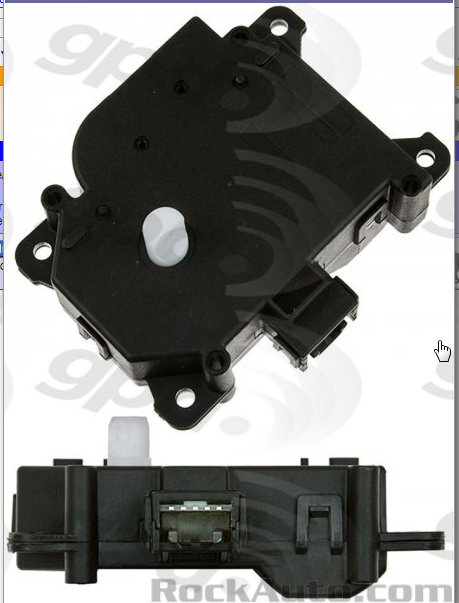

9. With the actuators assembly out, it is a simple process to replace either or both actuators. They are attached with a few screws and plastic clips.

12. Remove the white plastic wheel from the top actuator. Its just a clip on the shaft that releases it.
13. Seat the wheel in the shaft hole. This is a little tricky and will take some trial and error and perhaps a bit of study of the grooves. When you have it in correctly, you will feel it snap in and be able to rotate it toward the engine (clockwise) almost a full turn and see the levers move. If it isn't in correctly, it will turn only a little and bind. If this happens, check all the lever settings are in the positions from step 11 and try again. Remember, the wheel has to be in the correct position for the semicircle shaft of the actuator to seat -- I used a sharpie to mark the alignment when it clicked in so I could rotate test, but still come back to the correct starting position.
14. While keeping a bit of pressure to the whee so it doesn't unseat from the levers, slide the actuator back into position. This is another tricky part because if the wheel moves too much, it will no longer be connected properly to the lever arms which will likely cause something to break when the actuator turns under power. I had someone else with small hands hold the wheel in so I could use two hands to get the assembly back in. This takes some patience and a bit of maneuvering and wiggling, but the shaft should seat in the wheel and the arm for top front lever should also seat and connect.

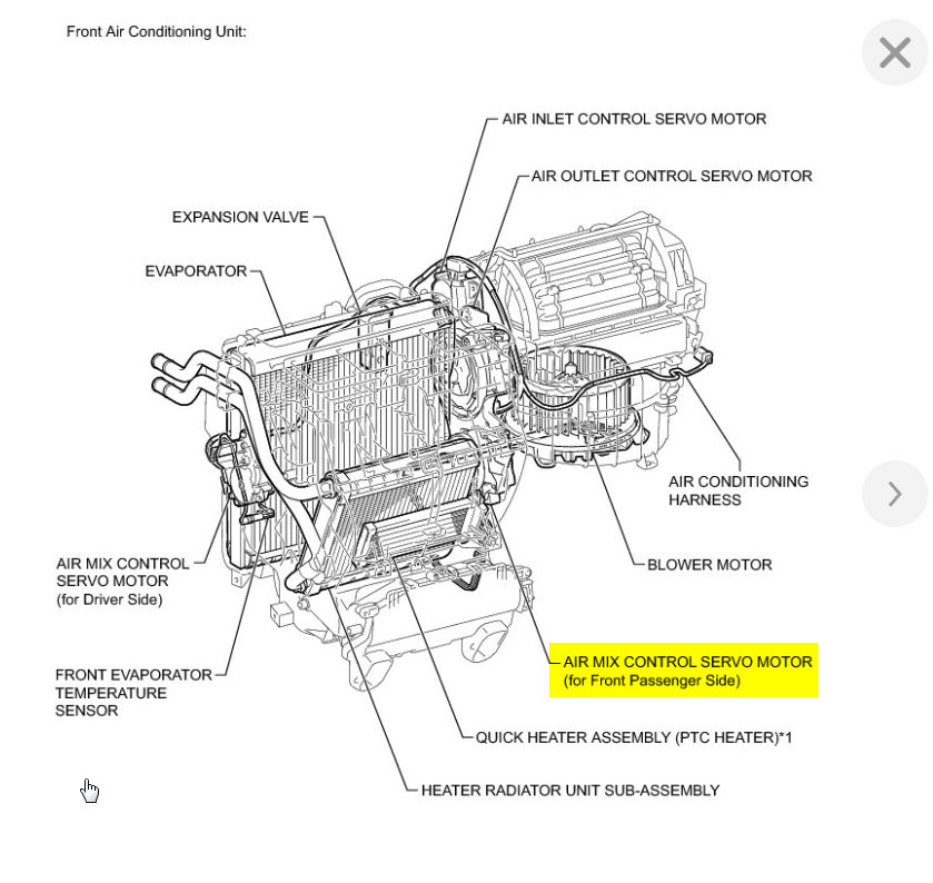

VA2019 - I have the same problem on my Toyota Highlander 2012 but a little worse. My semi-circle gear shaft broke off so the blend door for heat won't close.
I got the assembly loose, but I am super struggling on how to get it off because of the tightness of the blower motor.
