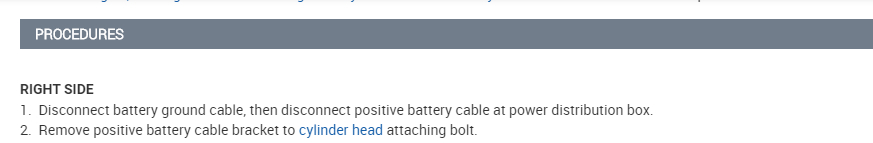

Hello, I am trying to change the battery cable due to multiple cuts in the cable and I cannot access the back bracket on the cable. I also would like to know what size it is and what is the best way to access the bolt on the bracket. Any suggestions would be appreciated.

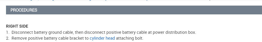

Unfortunately, this is one of those situations when the manual doesn't tell you how to remove it. It just tells you to remove it. See attached. Which means they just figured the mechanic would figure it out.

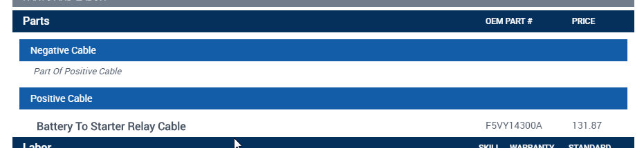

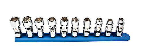

It has been a while since I did this but from what I remember, I use a swivel socket and air ratchet to get it off. I included the OEM part number for the battery cable but they are normally 6 gauge wire size if you would like to build your own.

Yeah. I am pretty sure you need a swivel socket and an extension so that the ratchet is out in space to turn it. More then likely you will need an 18 or 24 inch extension to get the angle correct and give yourself some space to turn the ratchet.
