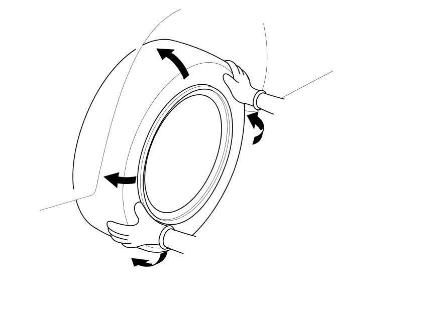

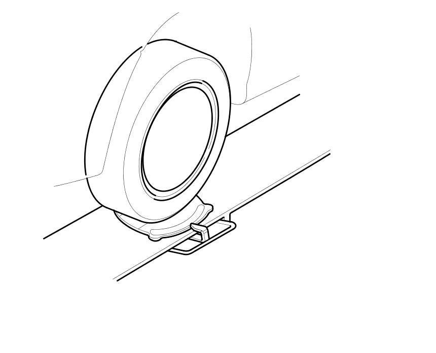

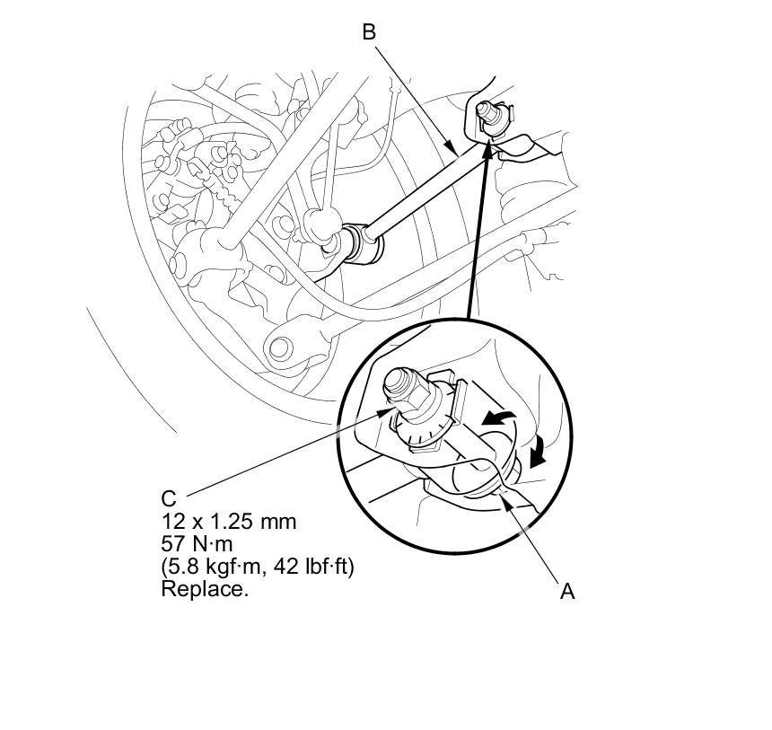

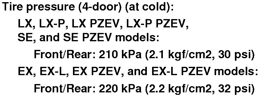

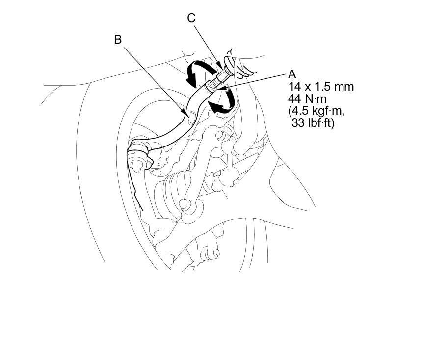

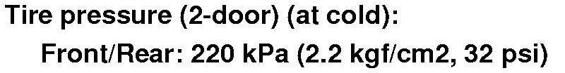

Hi everyone, i'm a tech at a shop and wanted to know when I'm performing a thrust angle alignment am I setting the steer ahead to the same spec as the thrust angle? If not then how do I ensure that the front wheels are parallel to the rear thrust angle?

The only thing adjustable on the rear is the toe. The idea of a thrust angle alignment is simply to confirm the rear axle is parallel to the front axle. When I do them, I always start by confirming rear toe and then move to the front. Actually, that is what is recommended by most.
Here are the directions. The attached pics correlate with the directions.

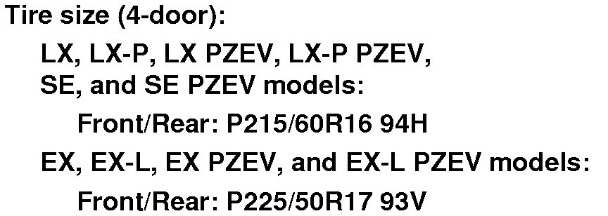

4. Check the tire size and tire pressure.
pic 1

6. Check the suspension ball joints (Raise and support the vehicle. Hold a tire with your hands, and move it up and down and right and left to check for movement).

8. Lower the vehicle to the ground. Bounce the vehicle up and down several times to stabilize the suspension.

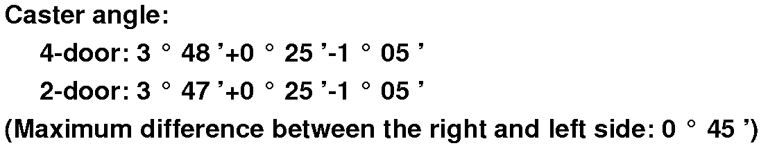

1. Check the caster angle.
pic 6
- If the measurement is within specifications, measure the camber angle.
- If the measurement is not within specifications, check for bent or damaged suspension components.

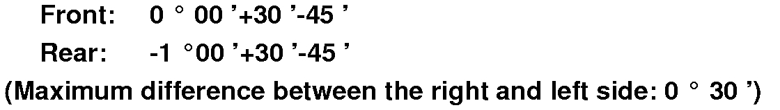

1. Check the camber angle.
Camber angle:
pic 7

3. Hold the adjusting bolt (A) on the rear control arm (B), and loosen the self-locking nut (C).
pic 9
4. Replace the self-locking nut with a new one, and lightly tighten it.
NOTE: Always use a new self-locking nut whenever it has been tightened to the specified torque.
5. Adjust the rear toe by turning the adjusting bolt until the toe is correct.
6. Tighten the self-locking nut while holding the adjusting bolt to the specified torque.

3. Loosen the tie-rod end locknuts (A) while holding the flat surface sections (B) of the tie-rod end with a wrench, and turn both tie-rods (C) until the front toe is within specifications.
pic 11
4. After adjusting, tighten the tie-rod end locknuts to the specified torque. Reposition the rack-end boot if it is twisted or displaced.
