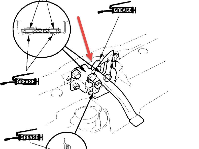

The last Saturday I replaced my RSX-S 2003 radiator... in order to do it I had to remove the hood lock mechanism... after the work was done I shut the hood and took the car for a short run to see everything is working right....
well... I arrived home and tried to open the hood again to check the coolant level, etc... I pulled the latch but the hood didn't open and there was little to no tension on it.
I have not been able to reach the cable or the spring in the mechanism to get the hood open...
I don't think the cable is broken, may be it is loose...
How to open my car hood?
I am very handy (I have done almost all the services of my vehicles... from motorcycles to super-duty trucks), and I have lot of tools available... cant believe that this stuck hood got me owned!!!
Should I go to a body shop or a mechanic???

you may get this from the bottom with a long screwdriver, etc. you might remove a shield form fascia/bumper and get to it. that is about all I can tell you . but try pushing down on hood then have an assistant pull cable it may be just out of adjustment. This guide can help as well
Check out the images (Below). Please let us know what happens.
