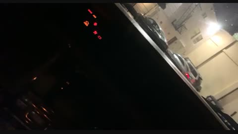

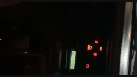

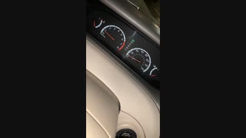

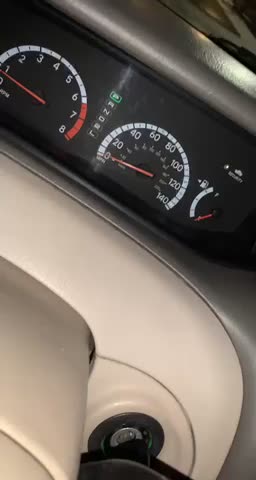

Our beloved car listed above 2 is being driven by my daughter. We recently spent $4,000.00 on it. Yesterday on her way to work she said there were several lights flashing on the dashboard. When she returned from work she took this video. Can you please help me understand if it is time for us to donate the car? Is it advisable to take it to a shop, and put more money into it? Thank you for your advice? Our concern is the reliability and cost of the car. It has had a good life.

The way we need to decide these things is to always start with getting the vehicle diagnosed to figure out exactly how much money we are talking about, otherwise we are just guessing. So, it is worth paying any diagnostic charges to get that dollar amount.
This means we need to start with at least getting the codes.
Also, the gauges flickering and lights coming on could be caused by a weak battery, so we need to also have the battery tested.
A parts store can do both of these free of charge. So, this is an example of why we want to have it diagnosed first. Many people react too quickly, and sell a car when it turns out to be a very simple and cheap issue.
