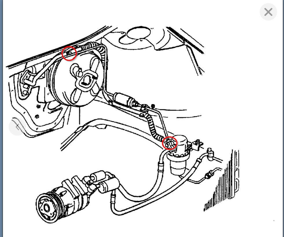

1997 BUICK CENTURY
150,000 MILES • 6 CYL • 2WD • AUTOMATIC
BEVERLY MAYHAN
can't find location to install.
Oct 19, 2021 at 4:31 AM
You are looking for the low side connection if you are using one of those fill cans.
Here are a couple guides that will help locate these:
https://www.2carpros.com/articles/air-conditioner-how-to-add-freon
This fitting is going to be on the low sideline. However, we don't have a location view on this. So, I am attaching a picture of where they should be.
Take a look at this and if you still can't find it then get some pictures of your engine bay, specifically the A/C lines and components and we will find it.
