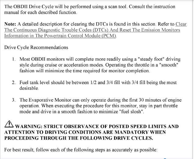

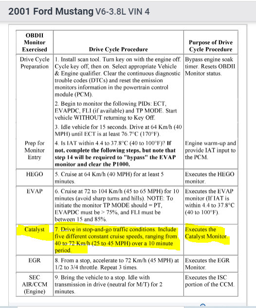

Is the catalytic converter the only system that isn't ready? I ask because clearing the continuous diagnostic trouble codes (DTCs) and resetting the emission monitor information or resetting the keep alive memory (KAM) causes the non-continuous monitors to change to a "NO" status. If all emissions are not ready, any of these can cause it.
If that isn't the case and the only one causing an issue is the catalyst, take a look through the directions below. I highlighted the section specific to catalyst readiness.
Let me know if that helps or if you have other questions.

If you have followed the drive cycle indicated, chances are something is failing but not setting a code.
In this case, you will need to find someone that can perform mode 6 testing. Mode 6 is basically defined as the test results and other components/system monitoring. The vehicle automatically runs self-tests on different systems and components to ensure proper operation. The easiest way I can describe it is this. Using a scan tool, a tech should be able to hook up and basically ask the PCM for the results of specific systems. In this case, the catalyst readiness.
Other than having that done, the only option I have is the drive cycle I provided.
