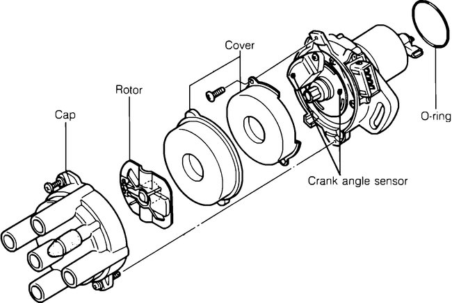

If you look at pic 1, it shows an exploded view of the distributor on this vehicle. Here is the manual's description of operation.
PURPOSE
Directs high voltage ignition coil output to spark plugs in proper sequence (firing order). A rotor on the driven shaft acts as a rotary contact, directing ignition coil voltage to each spark plug terminal as it turns inside the distributor cap.

Distributor utilizes a photo-diode type crank angle sensor consisting of a slotted disc that turns with the distributor shaft and a stationary pick-up assembly. As the disc rotates past the pick-up, the slots (one for each cylinder) alternately pass and block photo-diode light transmission. Signals generated are interpreted by the ECU to determine crank angle (#1 cylinder TDC) and engine rpm. To calculate ignition timing, the ECU uses this input together with several others related to vehicle operating conditions. Except for the initial setting, ignition timing is under ECU control.

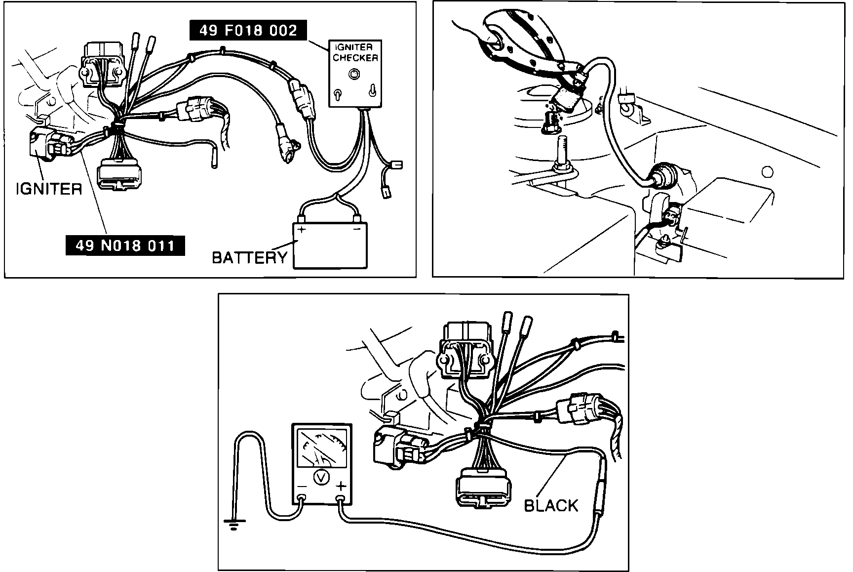

Here is the testing for the igniter.
1993 Mazda Protege L4-1839cc 1.8L SOHC
Component Tests and General Diagnostics
Vehicle Powertrain Management Relays and Modules - Powertrain Management Relays and Modules - Ignition System Ignition Control Module Testing and Inspection Component Tests and General Diagnostics
COMPONENT TESTS AND GENERAL DIAGNOSTICS
INSPECTION
Igniter Testing
pic 1
NOTE: This test requires Mazda Special Service Tools (SST) or aftermarket equivalents.
1. Disconnect igniter connector.
2. Connect adapter (SST #49 N018 011) between igniter and wiring harness.
3. Attach 4-pin connector of igniter checker (SST #49 F018 002) to adapter harness.
4. Connect igniter checker power leads to battery.
5. Turn ignition switch "ON."
6. Disconnect high tension coil lead from distributor cap and hold 0.20 - 0.39 in (5 - 10 mm) from a ground.
7. Flip SW2 "ON" and "OFF" and verify that strong blue sparks are discharged from the high tension lead.
CAUTION: Do not hold SW2 "ON" for longer than one second.
8. Replace the igniter if it does not perform as specified.
VOLTAGE TEST
Igniter Voltage Test
pic 2
1. With tools connected as described above, turn ignition "ON."
2. Connect voltmeter to terminal of black wire on adapter harness.
3. Flip SW2 "ON" and "OFF" and verify that voltmeter pointer fluctuates. Do not hold SW2 "ON" for longer than one second.

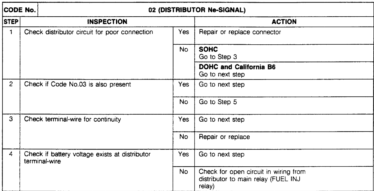

I have no specific test available to me for the sensor. However, if it has failed, there should be a diagnostic trouble code stored in the vehicle's computer. You don't need a scanner to retrieve the codes. All that's needed is a short jumper wire or even a paper clip. Here is a link that will walk you through getting codes from this system:
https://www.2carpros.com/articles/diagnostic-trouble-codes-for-1995-and-earlier-mazda-cars-obd1

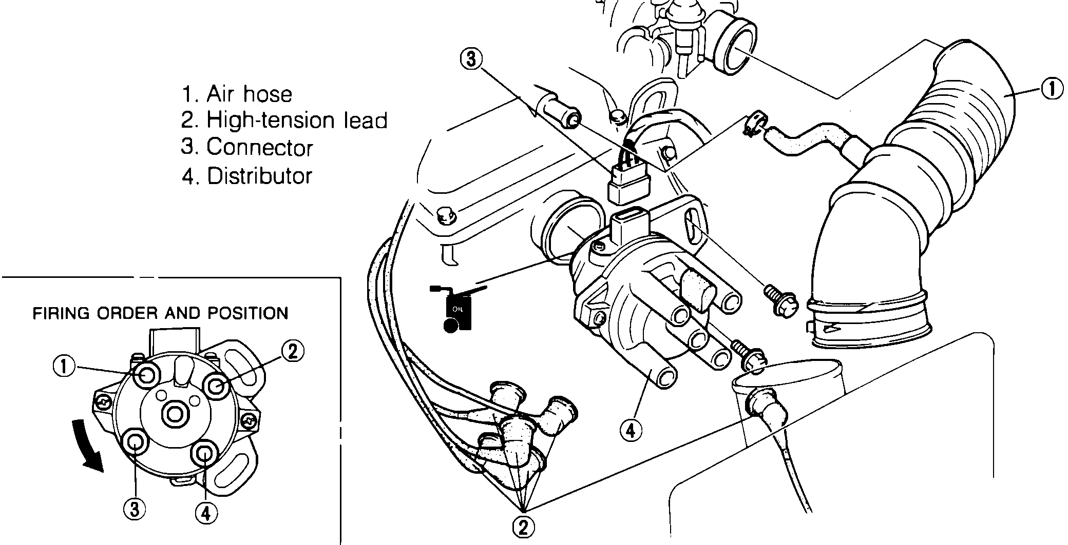

Here are directions for replacing the distributor. I don't know if you have a SOHC or DOHC engine. Here are the directions for the SOHC. If you do this, place the crankshaft at top dead center (TDC) and before removing the distributor, make sure the rotor in the distributor is pointing at the number 1 cylinder spark plug wire. When a new one is installed, do the same.
Procedures
Vehicle Powertrain Management Ignition System Distributor Service and Repair Procedures
PROCEDURES
Distributor Replacement
Pic 1
REMOVAL
1. Remove high tension leads.
2. Disconnect wiring harness.
3. Turn crankshaft to #1 cylinder TDC.
4. Remove mounting bolt and lift off distributor. Do not turn engine while distributor is removed.
INSTALLATION
Install in the reverse order of removal and note the following:
1. Coat the O-ring with engine oil.
2. Ensure that #1 cylinder is at TDC.
3. Align distributor drive blade with slot in camshaft.
4. After installation, adjust ignition timing (see Adjustments).
5. Tighten mounting bolt to 14 - 19 ft lb (19 - 25 Nm).

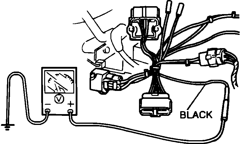

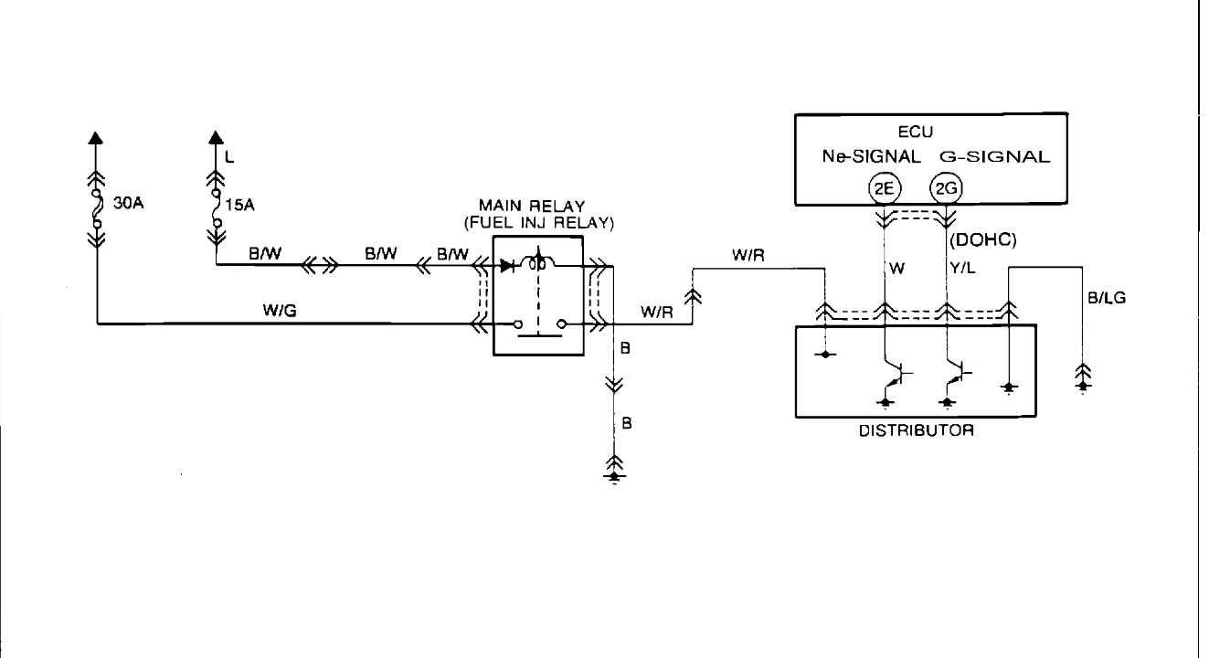

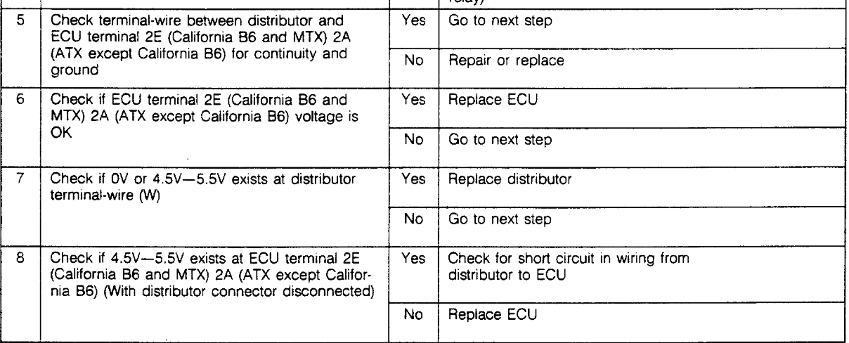

That is actually a code 2 which repeated itself. It indicated no Ne signal. The coil firing reluctor provides the Ne signal, which is rpm information. Without the signal, you have no spark. That's why it won't start. Now, before we just replace the distributor, here is a flow chart to check and confirm what the problem is. I don't know where you are located, but the directions are for both Federal and CA emissions on a Manual transmission.
The directions for testing are in the pictures below. Let me know if they helps or if you need help.
Dec 30, 2019 at 2:58 PM
DYCAR2008
  • 18 POSTS
What is the required battery voltage exits at distributor terminal wires?
I have 3 wires going into the top of the distributor. One is black another one is white with red stripe and another one is white.
What does Acronyms W/R, W, W/G, Y/L, B/LG mean?
Thanks for your help.
Jan 1, 2020 at 6:45 AM
  • 110,248 POSTS
The acronyms refer to wire color. See below. If you aren't familiar with wiring schematics, L refers to blue. I know that doesn't seem rational, but with a black wire more common, B stands for black, so they used L for Blue.
Here are the color references:
W/R White with red tracer
W White
W/G White with green tracer
Y/L Yellow with blue tracer
B/LG Blue / with a light green tracer.

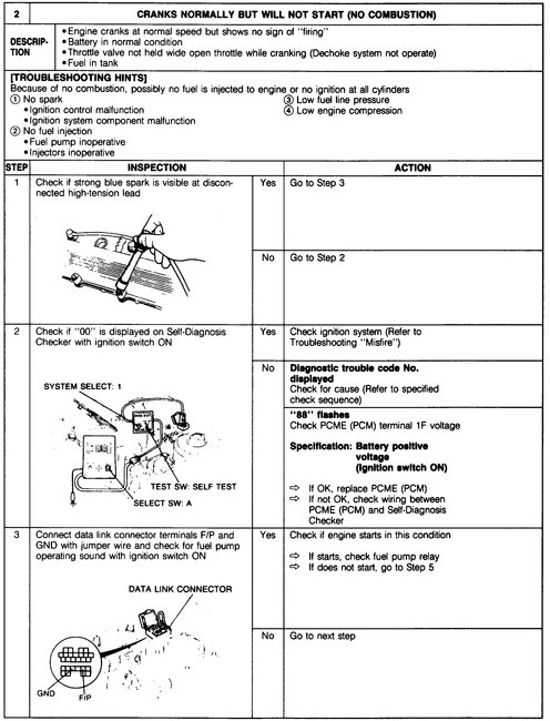

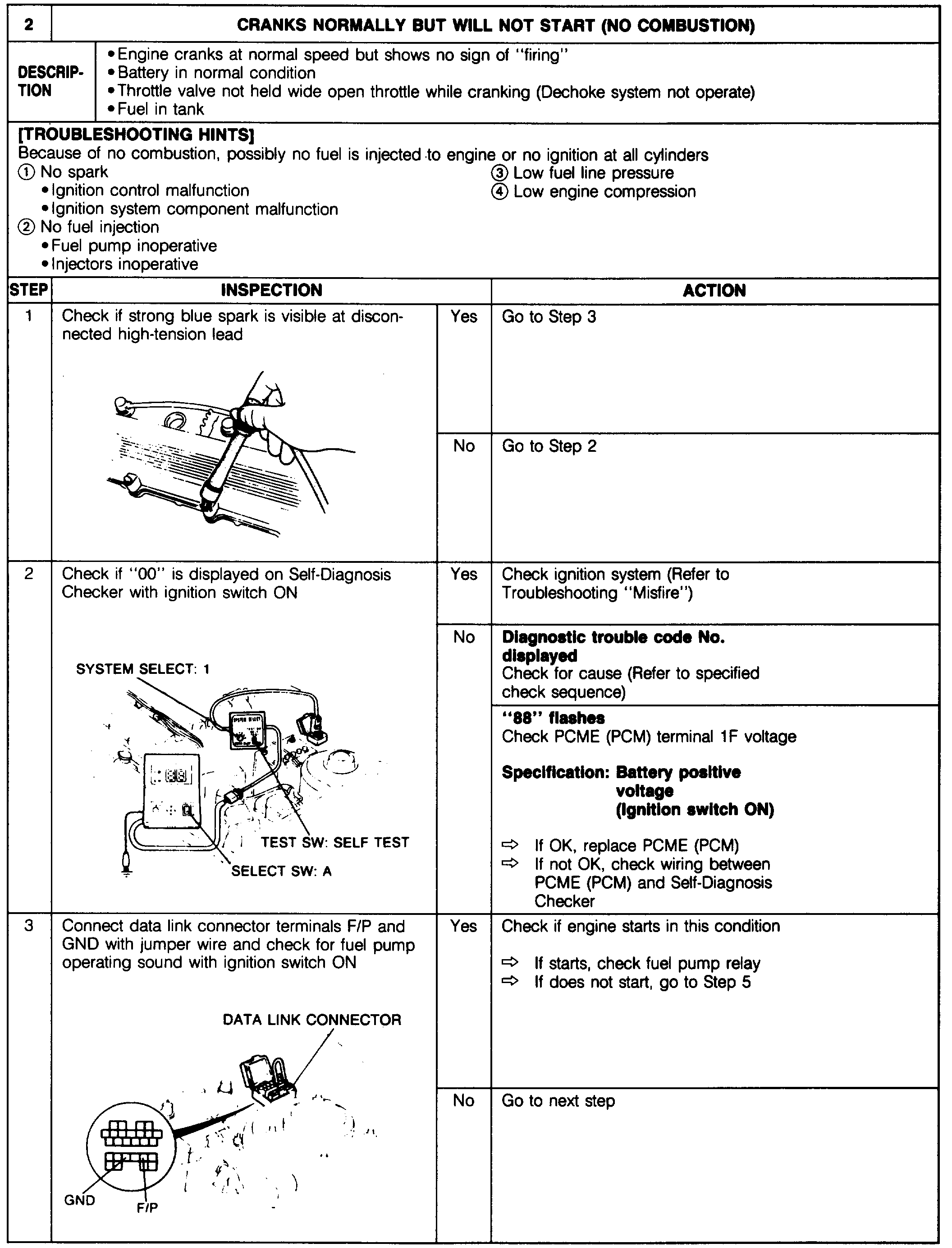

Because of the year, my manual isn't providing the test procedures specific to the crank angle sensor. The only thing I was able to find was a flow chart for a no spark condition which I have attached.
Jan 4, 2020 at 10:45 AM
