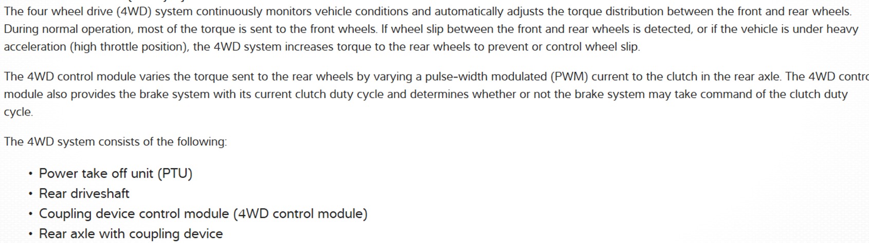

This has the automatic 4wd. I guess that's what you call it. There is no selector switch. But it has a 4wd indicator light (idiot light) in instrument panel and has a 4wd imprint design in dash. No selector switch or anything though. A few months ago the 4wd flashed indicating the tone ring was a problem and I found the drivers side ring broke. I replaced it and the ABS sensor. I was told at one point the 4wd light had come on when it was being driven but can't remember if she told me what road conditions were plus I can't remember if this was before or after I replaced tone ring. We live in Northeast Pa and have had plenty of snowy and icy roads. We both have driven it and have never seen the 4wd light come on at all. And conditions definitely sucked. The wife has stated the vehicle has slid a few times on some hills. How can I find out if it is or isn't working. I have a Hayes manual and looking in the chassis electrical schematics I noticed a wire leading to what is listed as. 4wd control module. There is no other reference to this module anywhere in the book. In fact not much if any info at all about this type of 4wd system. Can you help explain this system and how to troubleshoot it?

it's an automatic system so it only puts 4wd incertain conditions. you need a scanner to diagnose it and there are 10 separate tests which should be covered in your Haynes manual. From your description it seems to be operating correctly. Although any ABS problem will knock it out along with traction control.

I am working on a 05 escape and the 4 wheel drive does not work. The ABS light comes on, and the 4 wheel drive light comes on and flashes. There is no shifter inside, it is automatic. I need to start troubleshooting, what should I check first?

scan for codes with a tool that reads p b c and u codes
you have an abs problem and traction problem, both need the scanner to avoid replacing parts that aren't needed.

My scanner will do powertrain codes and there are none. Whats the resistance on the wheel sensors. One wheel bearing sounds dry(is not hub assembly). Any wiring diagram would help. thanks

Ford wheel speed sensors are 800-2300 ohm. you really need to scan with a capable tool!

I found the problem, ABS sens ring reluctor was cracked and came off shaft. Put new one on CV shaft and vehicle works fine.
