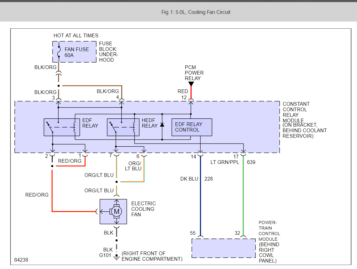

Drove the car around for a half hour put the top up turn on air ran it for twenty minutes car was starting to get hot.

There is a cooling fan relay that sounds like it went out. I would also replace the cooling fan which can overload the relay.
Here are some guides to help you get the problem fixed and a wiring diagram (below):
https://www.2carpros.com/articles/replace-electric-fan-motor
and
https://www.2carpros.com/articles/engine-overheating-or-running-hot
