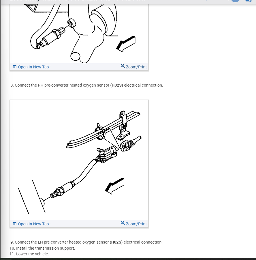

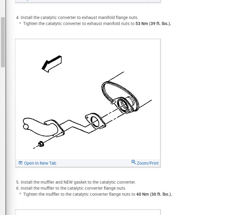

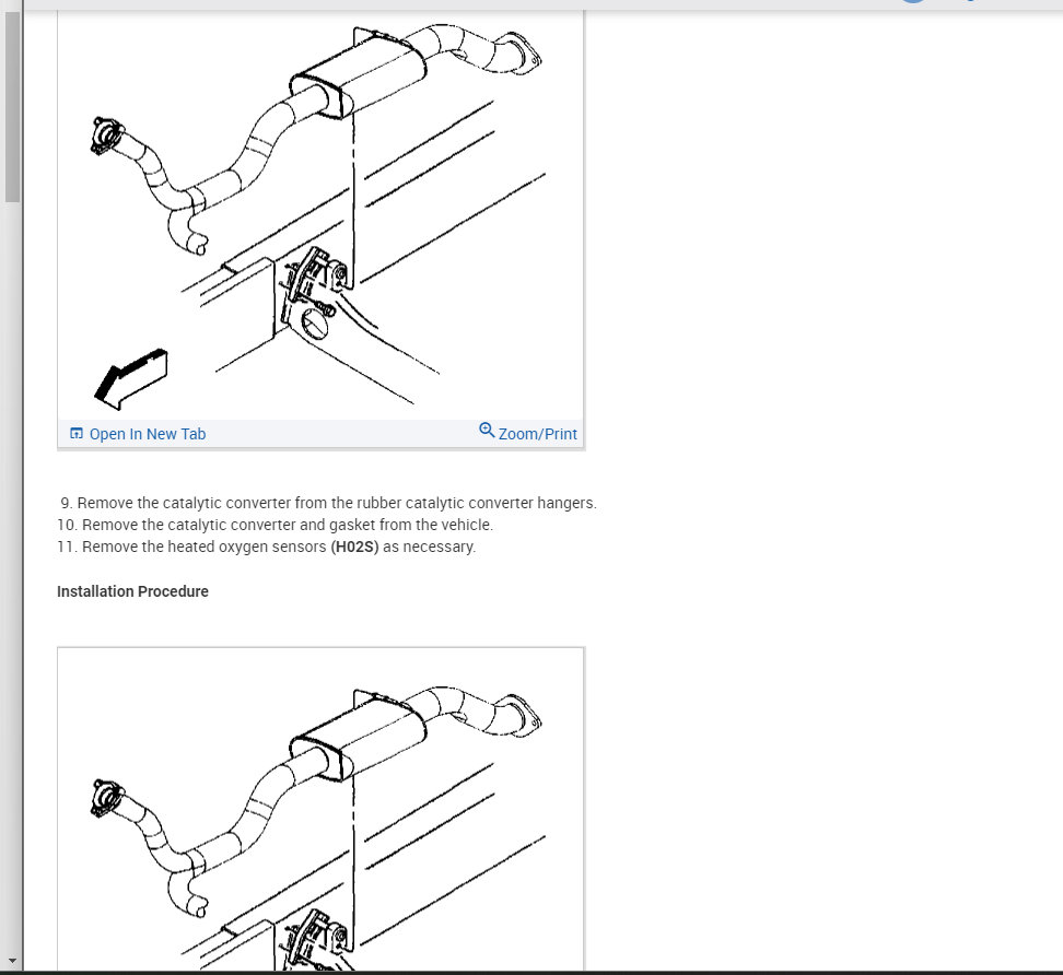

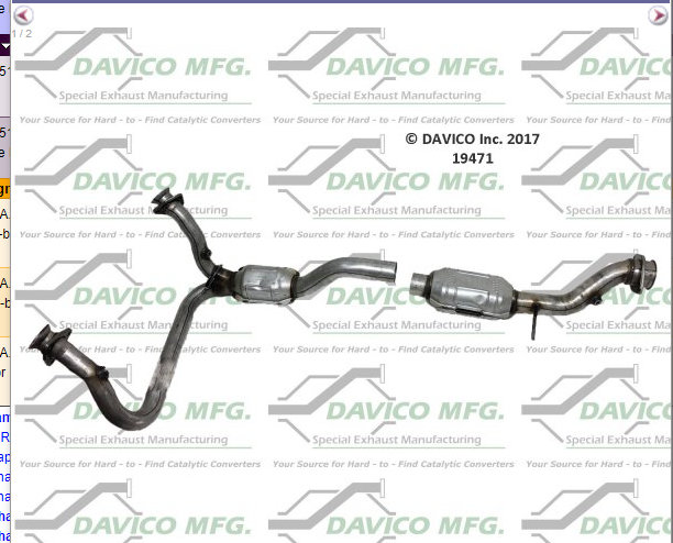

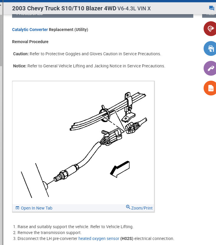

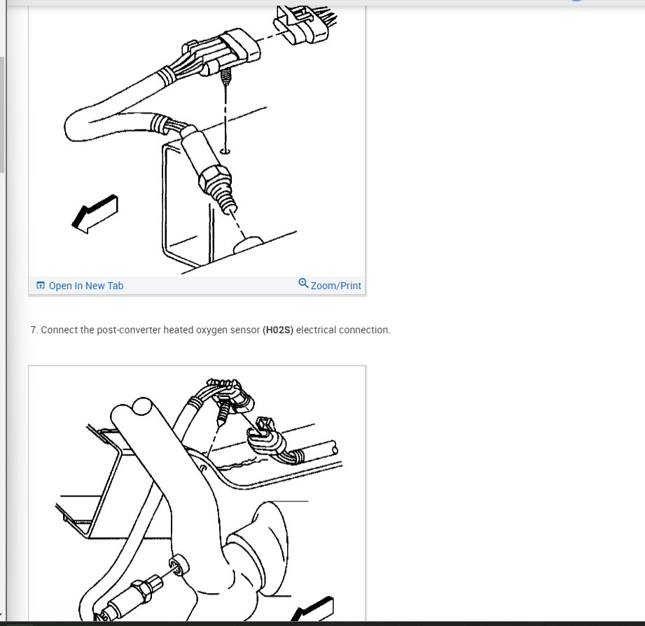

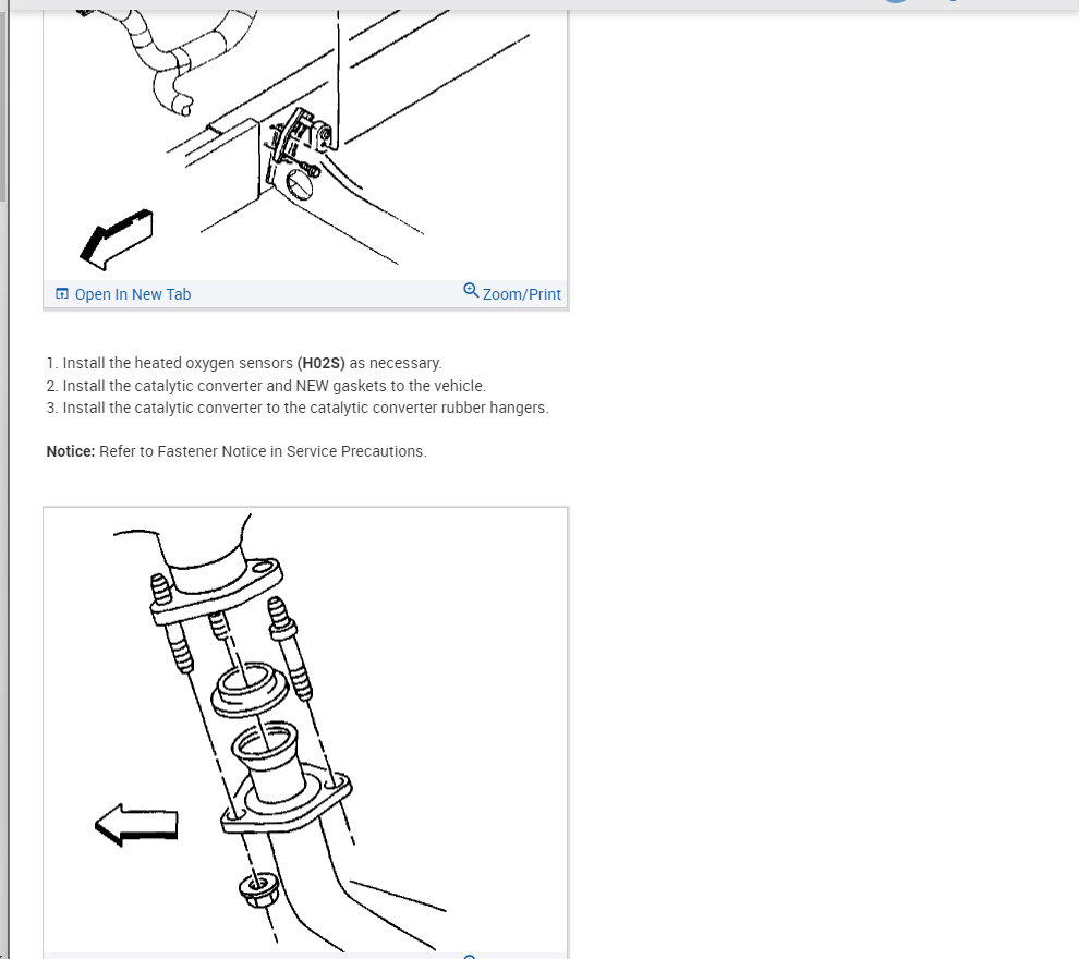

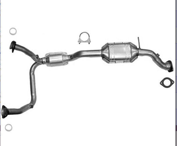

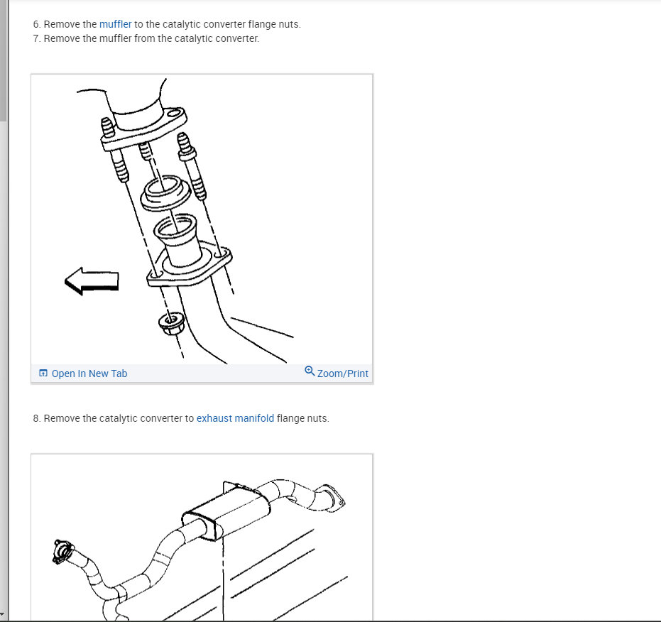

Technically this only has one replacement part but there are two converters that are part of the front pipe.

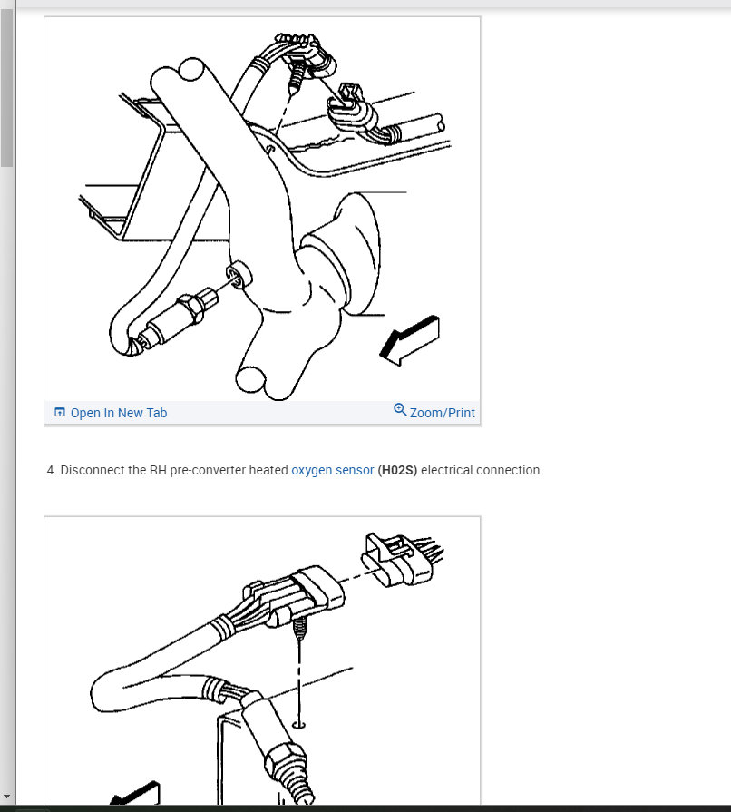

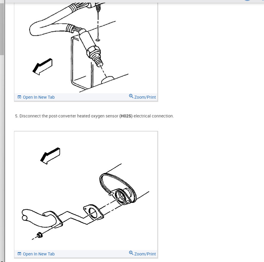

I see that you can get options that have a separation between the two converters, but you can always tell how many converters you have by finding the upstream o2 sensors and then any converter that is after them and prior to the downstream o2 sensor is technically a converter.
So, the o2 sensors are after both of these converters in the front pipe.
Here is a guide that will help with testing this if needed:
https://youtu.be/kNXh1Lphzr4
Please run through this info below and let me know if you have other questions.
