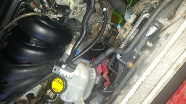

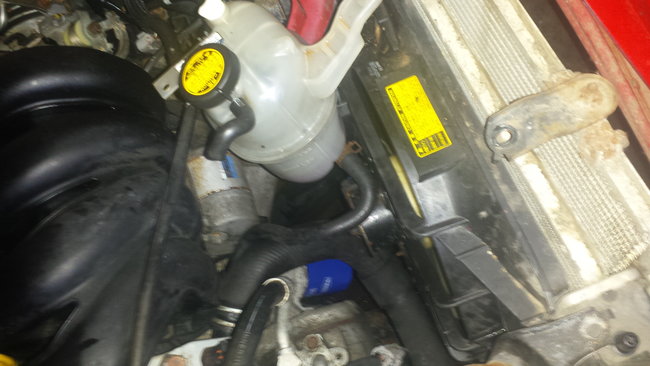

Thanks for the reply. There is bleed valve located just right above the reservoir next to the cap. What is the best way to do bleed it using the reservoir? See picture attached.

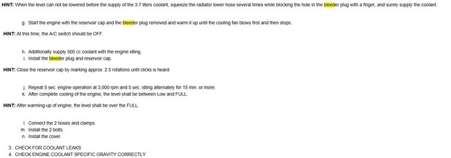

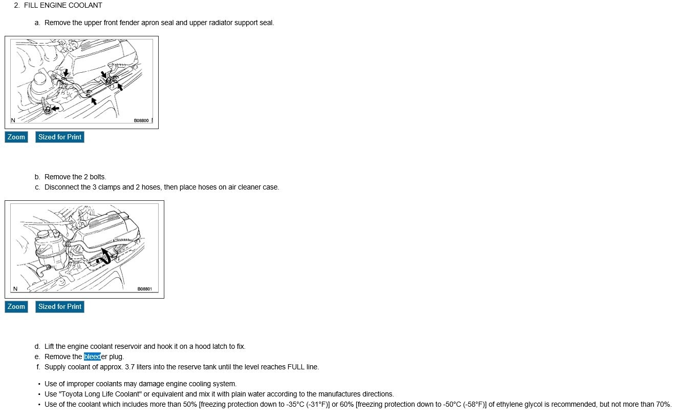

Here is the procedure.

Hi. Thanks for the reply. I am a bit confused with one of the instruction (c). It says I need to disconnect two hoses and place them on the air cleaner case. Is that mean I disconnect two hoses away from the reservoir? And if so, which of the two hoses that needs to be disconnected? I see three hose. One from the bottom of the reservoir and two from top side of the reservoir. Thanks.

I was a bit confused also when I was reading that and as far as I can tell they wanted you to unbolt the coolant reservoir than lift it up and affix it to the hood latch. I assume this is to get the reservoir higher than the rest of the cooling system so the air will rise to the top (the reservoir).
Now about them hoses in C, I assume they mean getting them hoses free as if they were secured somehow, but I don't think they actually mean disconnect any hose cause coolant would leak out, although I could be wrong.
If it were me I would just jack up that side where the reservoir is or pull that side up on a curb and then follow the rest, which includes removing the bleeder plug.
