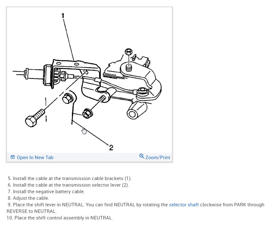

Trying to move my car but I have no key I want to get it into neutral.
Monday, July 1st, 2019 AT 9:34 AM
Hi Obinbalan,

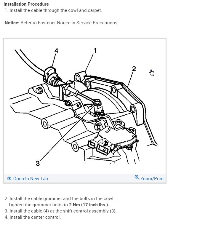

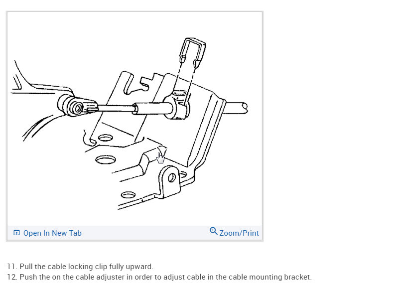

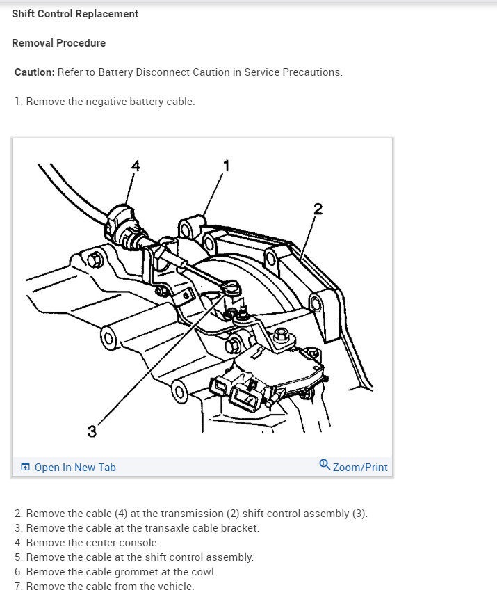

The easiest way that I know to do this is just pop off the shifter cable from the transmission and manually shift the transmission manual valve to neutral so you can move the vehicle.
Here is the process to replace the cable. All you need is the first part but since it was only a couple pages, I figured I would just give you the entire process in case you need it in the future for some reason.
Let me know if you need more information. Thanks
