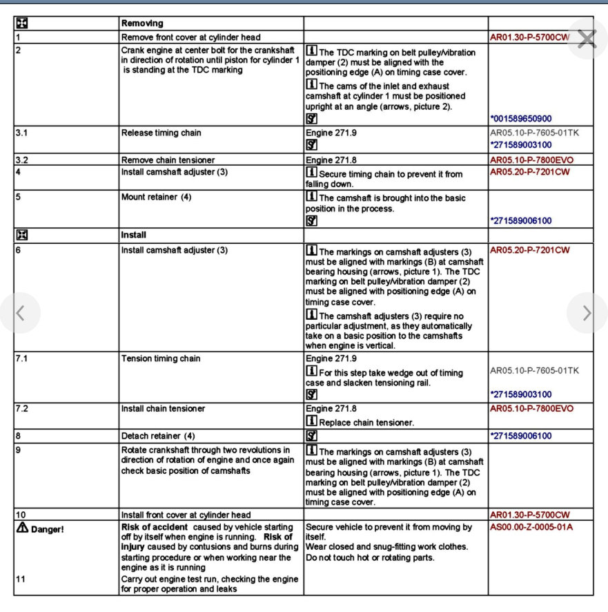

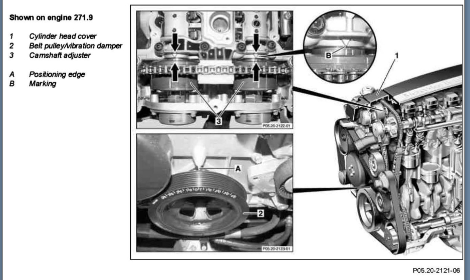

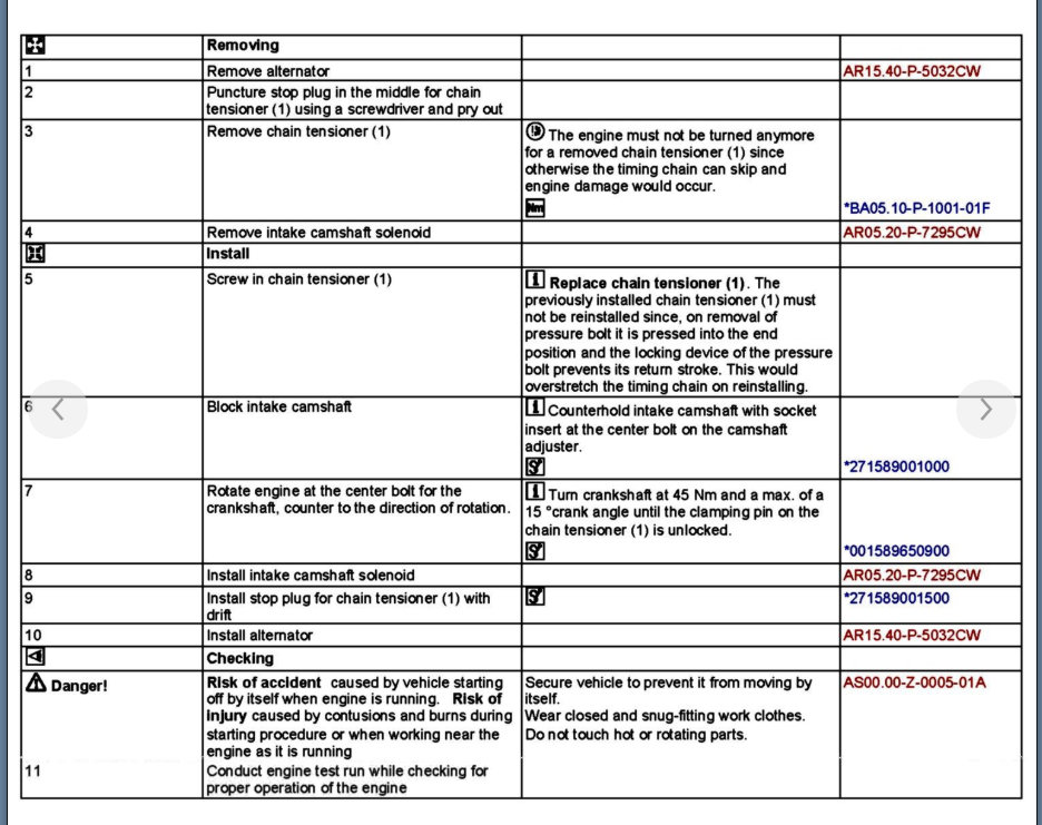

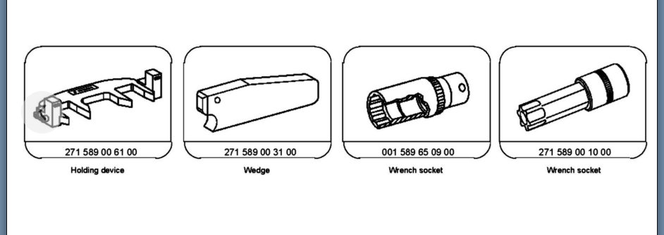

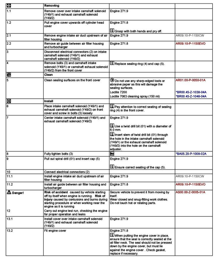

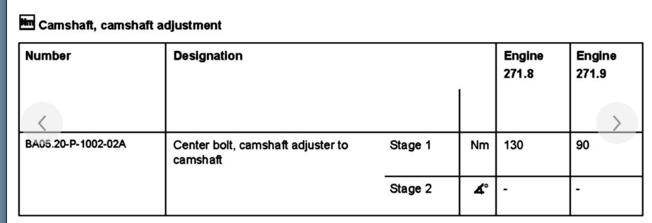

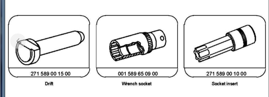

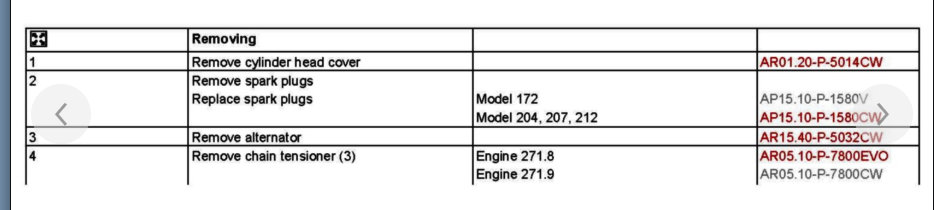

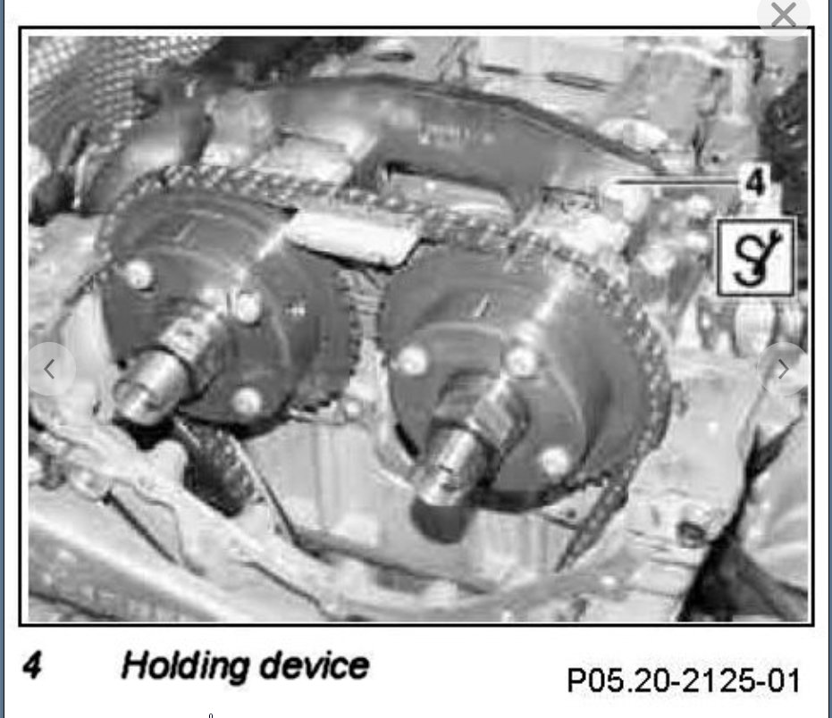

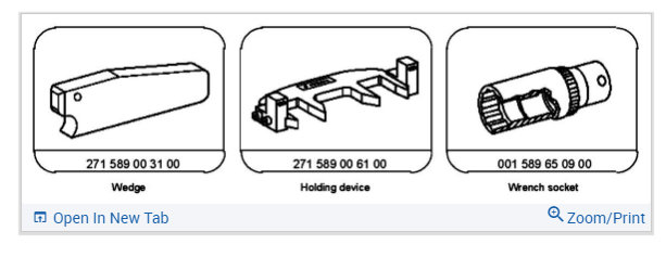

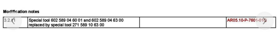

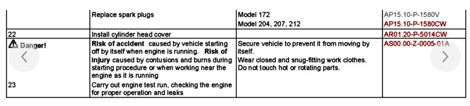

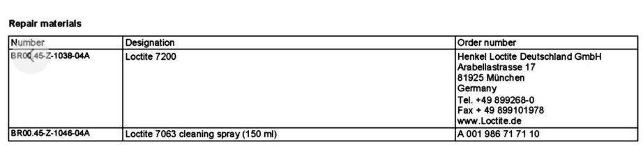

I want to know how to change my chain tensioner. I mostly want to know if there are any special instructions when taking it off and installing.
Feb 8, 2020 at 3:09 AM
There are not any unique instructions but there are things that need to be done to ensure you don't have an issue after. They are laid out in these instructions. Let me know if you need more info and I will see what I can find to answer those questions. Thanks

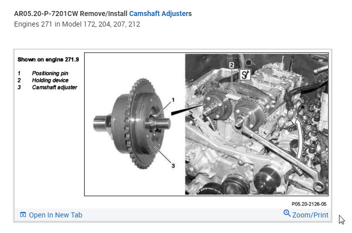

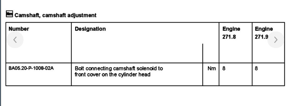

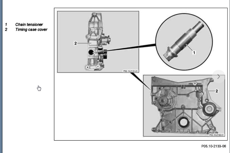

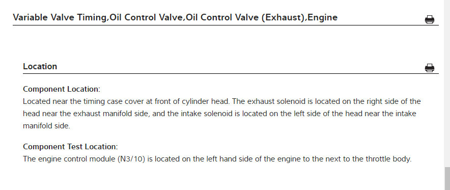

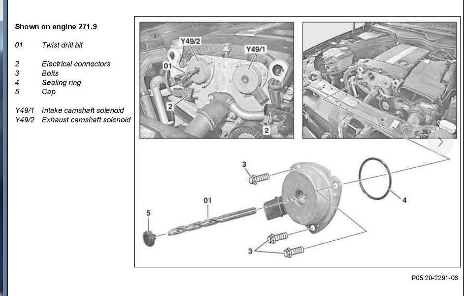

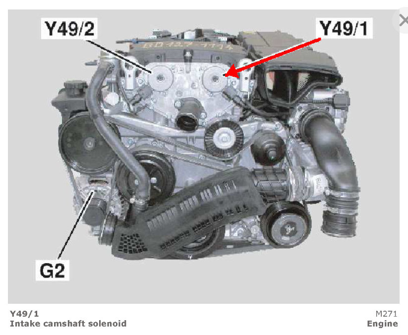

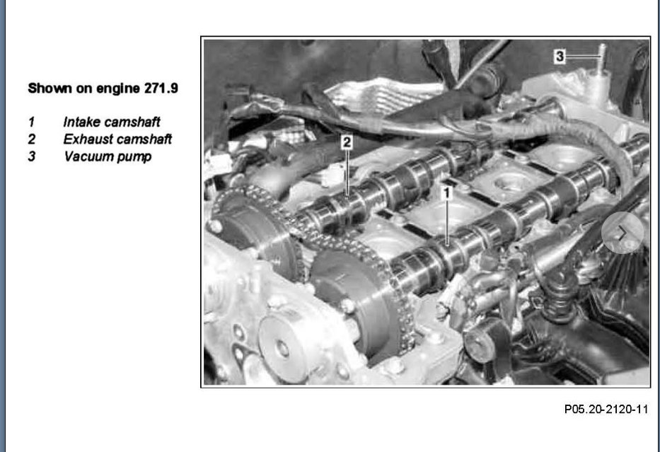

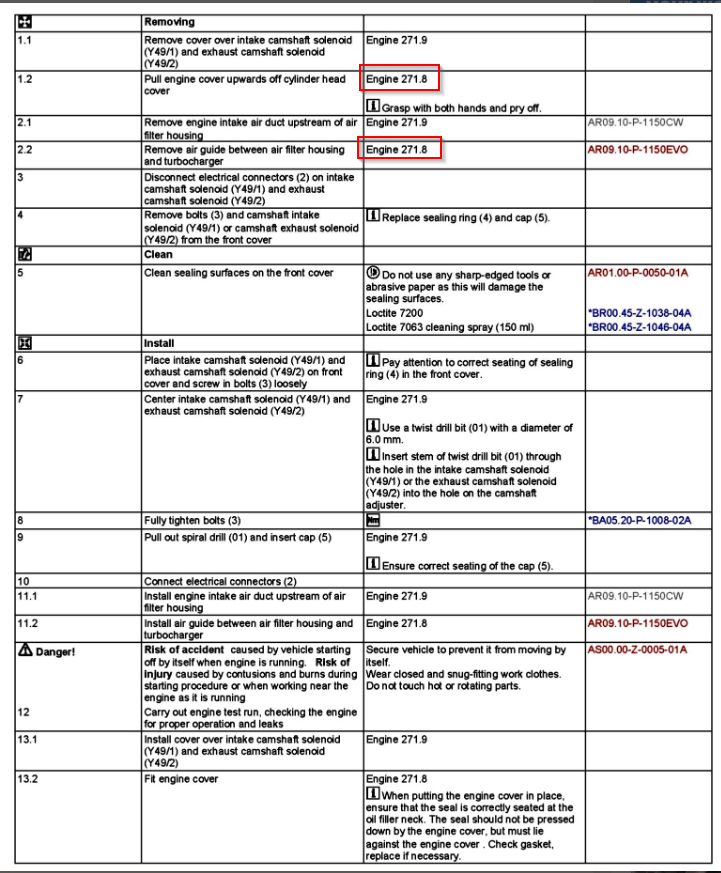

Thanks for the reply. where do I find the intake camshaft solenoid?
Feb 8, 2020 at 3:37 AM
I attached the info for this. Let me know if you have other questions. Thanks

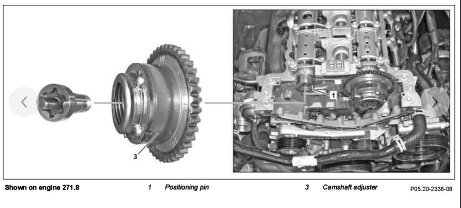

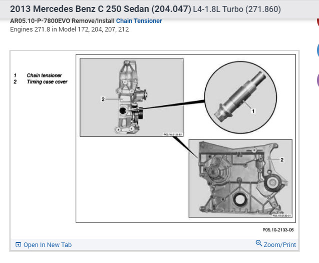

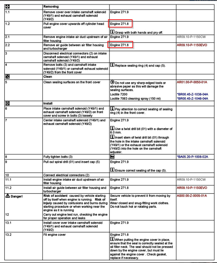

Thank you, but my engine is the 271.8. for the solenoid diagram could I get one for my engine?
Feb 8, 2020 at 5:38 PM
Sorry. I don't have a picture of your engine showing the location however, they should be in about the same place which is on the fronts of the camshafts. The picture may not be your engine because the service manual didn't give options of engines. I didn't notice it was different however, the directions call out the specific differences in the directions. If you look at the attachment, I circled the 271.8 steps. So you follow all the steps except those that say they are for a different engine.

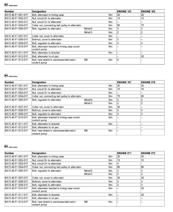

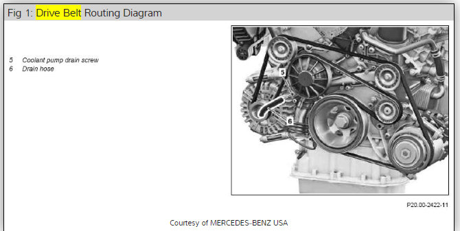

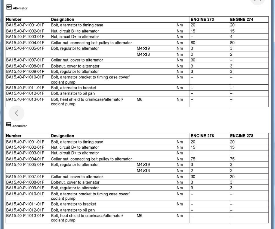

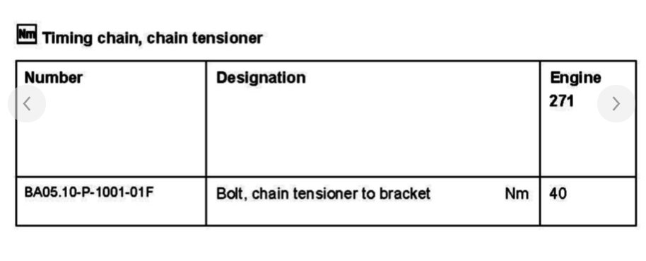

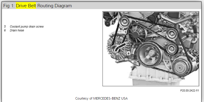

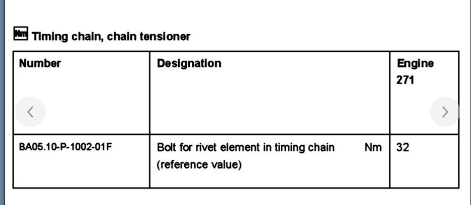

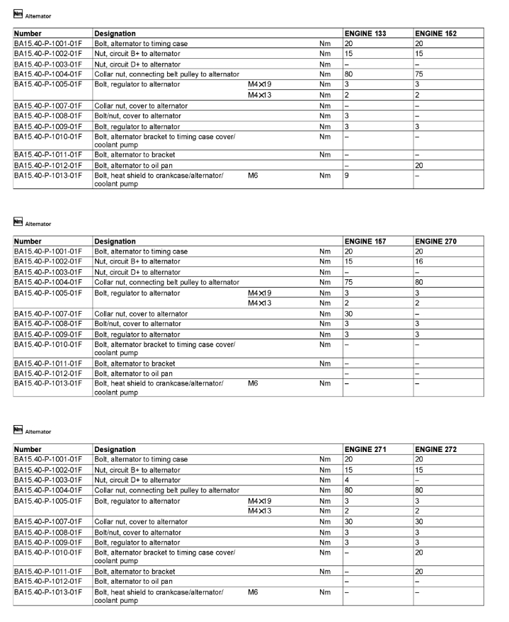

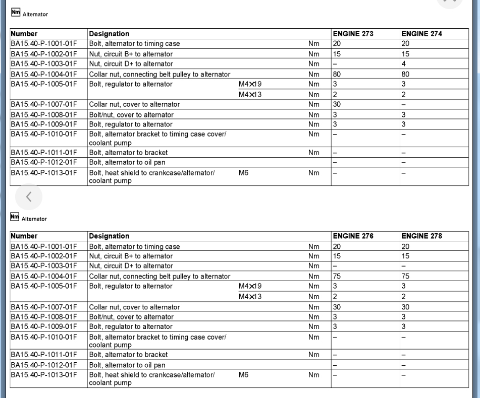

Can I get a diagram of the serpentine belt and can I also get torque specs for the alternator?
Feb 20, 2020 at 12:35 AM
I think you have the 271 engine correct? If so the alternator torque specs are included. I put them all there but made sure 271 was included.

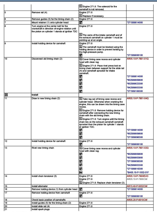

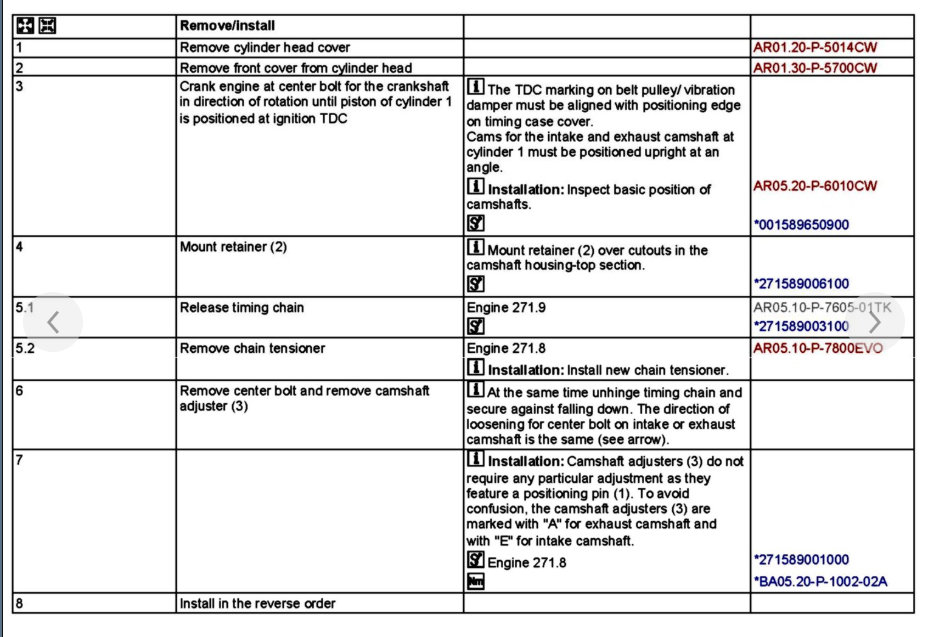

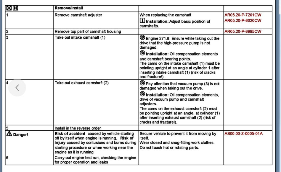

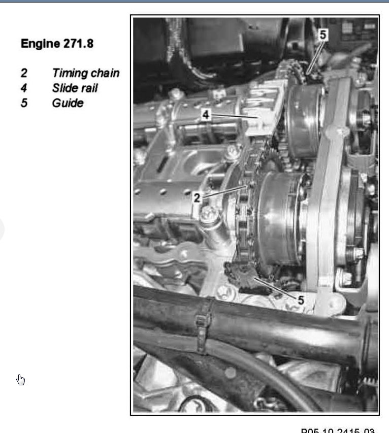

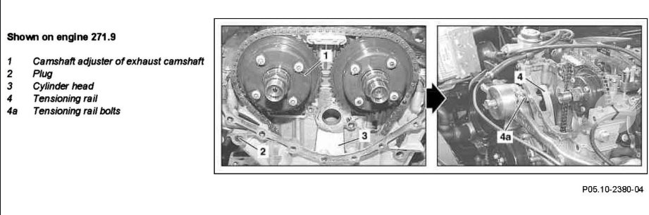

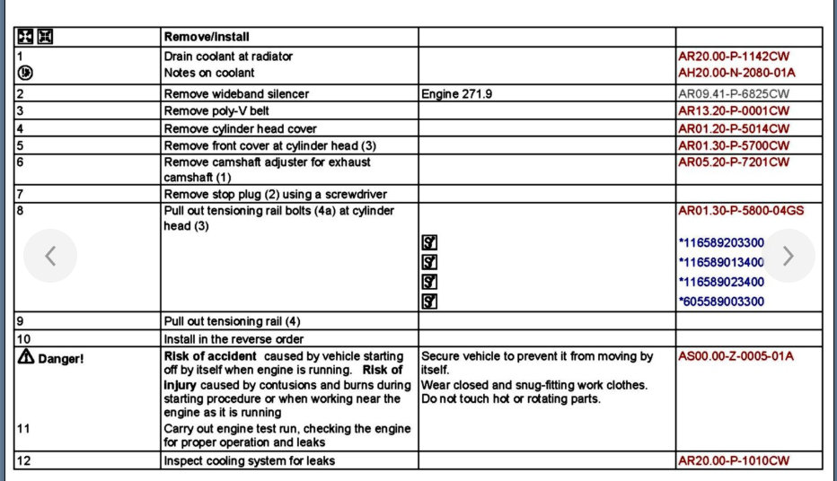

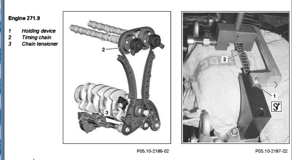

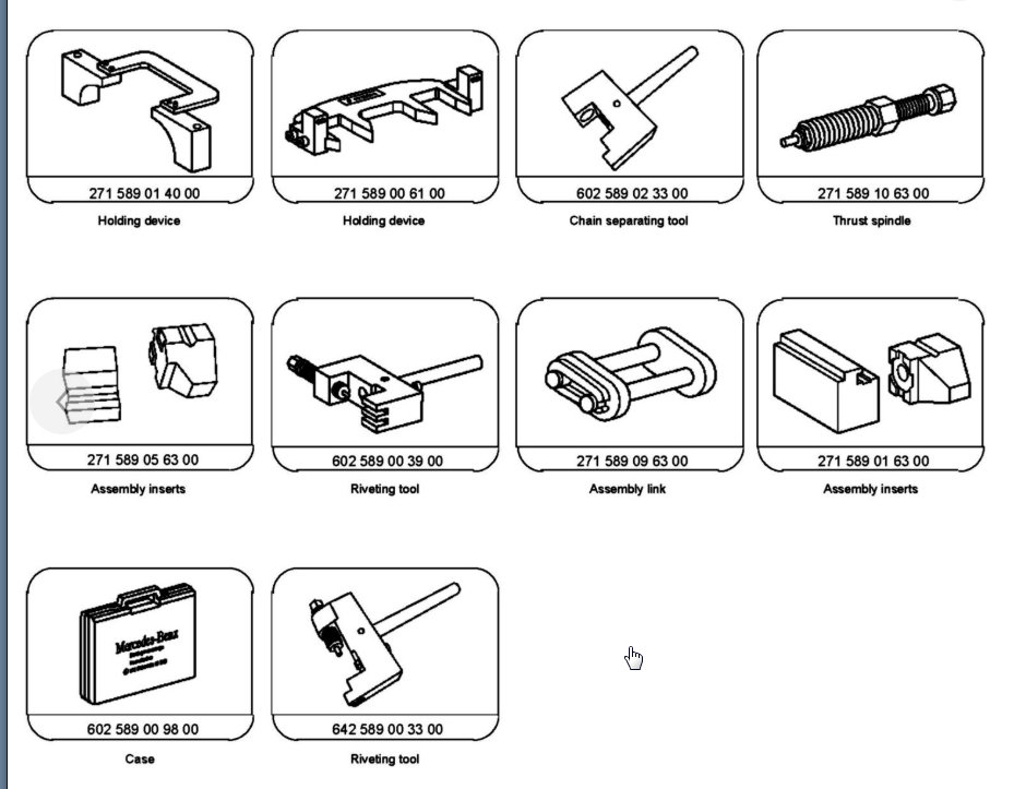

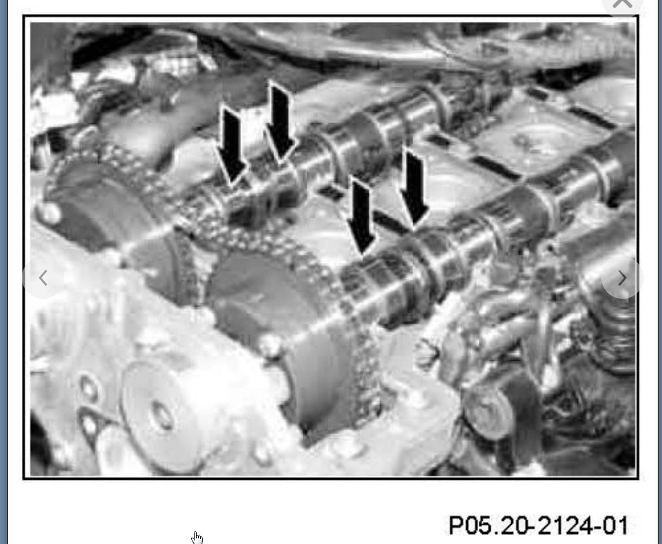

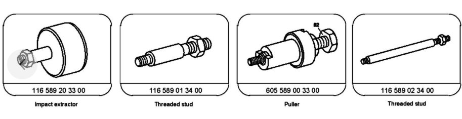

So my job got a whole lot bigger. I need to change my camshafts and timing chain and timing chain guide since it broke. can I get help please?
Feb 25, 2020 at 12:41 PM
I attached the processes for camshafts and timing chains and guides. I am not a big fan of these manuals because they are not streamline. However, it appears it is all there.
