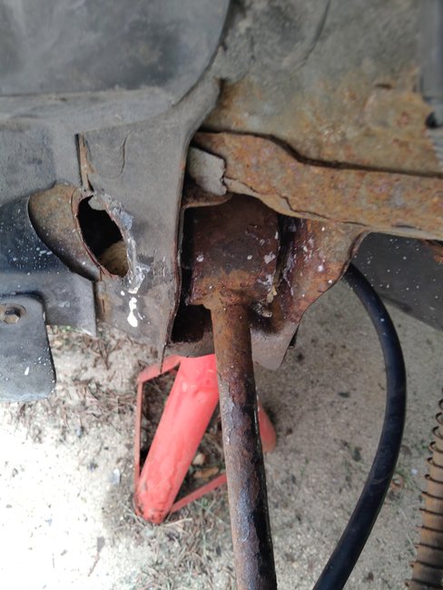

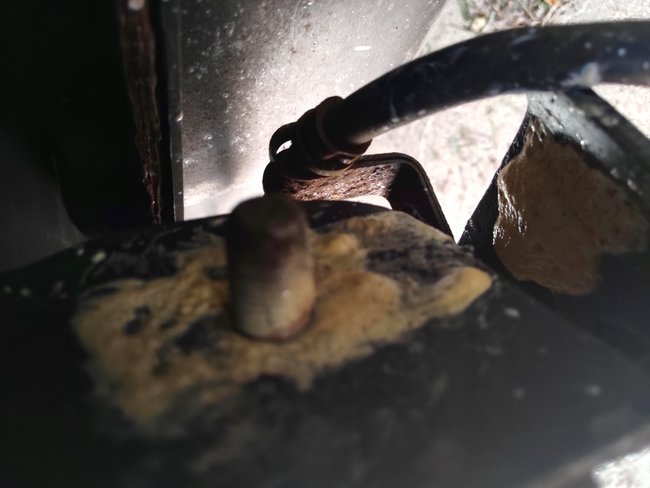

I'm trying to replace the rear driver side trailing arm and the bolt seems rusted to the frame and bushing.
I have tried PB Blaster multiple times and it hasn't loosened the bolt. I have tried hammering it out to no avail.
I also tried using a vice to press the bolt through but ended up just bending part of the car frame.

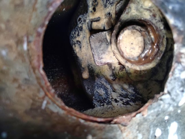

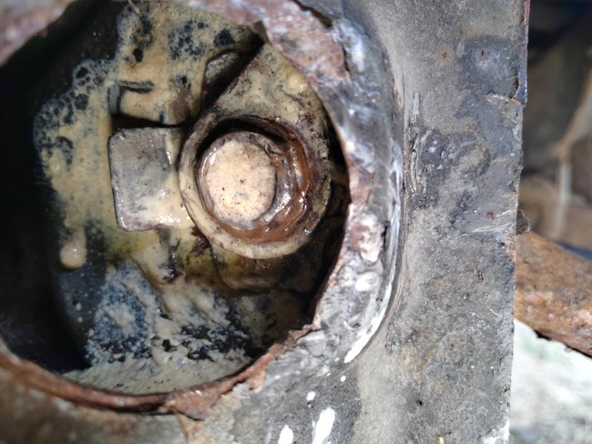

The head of the bolt seems to have some kind of locking mechanism on it, this makes it very hard to keep a socket on it without slipping.
Any help is appreciated. I plan on replacing the rear passenger side as well.

Wow, you got a tough one there. Have you tried using an air hammer? Usually, the vibration breaks them loose. Also, have you tried heat? If you get it hot enough, it will expand. Then, hit it with a heavy hammer.
