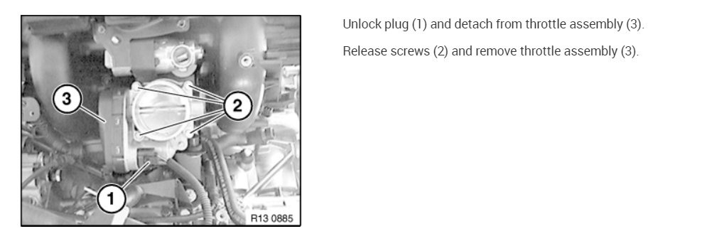

Codes p1895 and p1625 are the main ones I'm worried about, I drove it home and the next day wouldn't start, and it doesn't crank over. lights and everything come on but it wont start and we need to move it because it's parked 2 blocks away on a cross street. They will tow it. Any advice please help?
Aug 17, 2022 at 8:17 PM
  • 54,837 POSTS

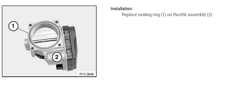

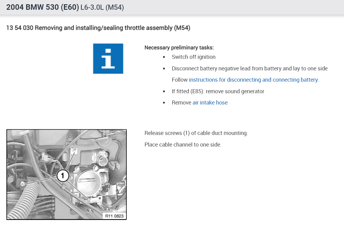

Codes p1895 is for a bad TCM and the p1625 code is for a bad throttle pedal sensor but I have seen if you clean the throttle bore this code might go away so you can get the car moved. Also, check all fuses, here are two guides to help us:
and
Check out the diagrams (below). Please let us know what happens. You can try clearing the codes as well.
