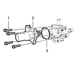

I need to bypass the thermostat to use blue devil gasket sealer. To try an fix head gasket leak. As per the the instructions. What is the best way to do this? I was going to use pvc and connect the hoses that way, but it I'm thinking there must be a better way.

It can't be bypassed simply because it is attached directly to the radiator. What I would suggest is to remove the thermostat when performing the procedure. Once you finish and everything is finished, reinstall the thermostat.
Here are directions for removal and replacement. The attached pics correlate with the directions.

Removal Procedure
Engine Coolant Thermostat Housing Replacement Remove
Note, coolant must be drained to a level below the thermostat. Otherwise, it will leak from that point.
Bolt (1) total 4 Remove
pic 1
Remove the thermostat. (2)
Engine Coolant Thermostat Gasket (3) Remove and DISCARD

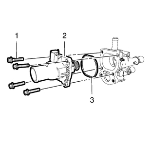

Installation Procedure
Install a NEW gasket. (3)
pic 2
Install the thermostat. (2)
Engine Coolant Thermostat Housing Replacement Install
