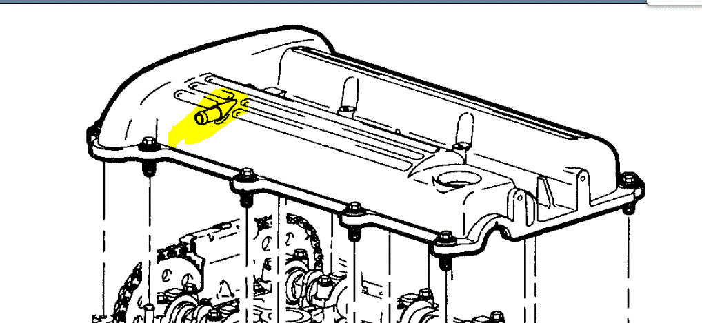

I attached a pic below and highlighted where the PCV hose will attach to the valve cover (where the oil cap is located). Start the engine and remove the hose from the valve cover and see if there is a vacuum being produced in that hose. That hose will go to the intake, so there should be a strong vacuum when the engine is running. Also, it may even cause the engine to stall. At a minimum, it will run rough and change the idle speed.
If there isn't, turn the engine off and remove the hose and inspect it for being plugged. Also, check the valve cover to make sure it isn't plugged as well.

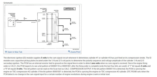

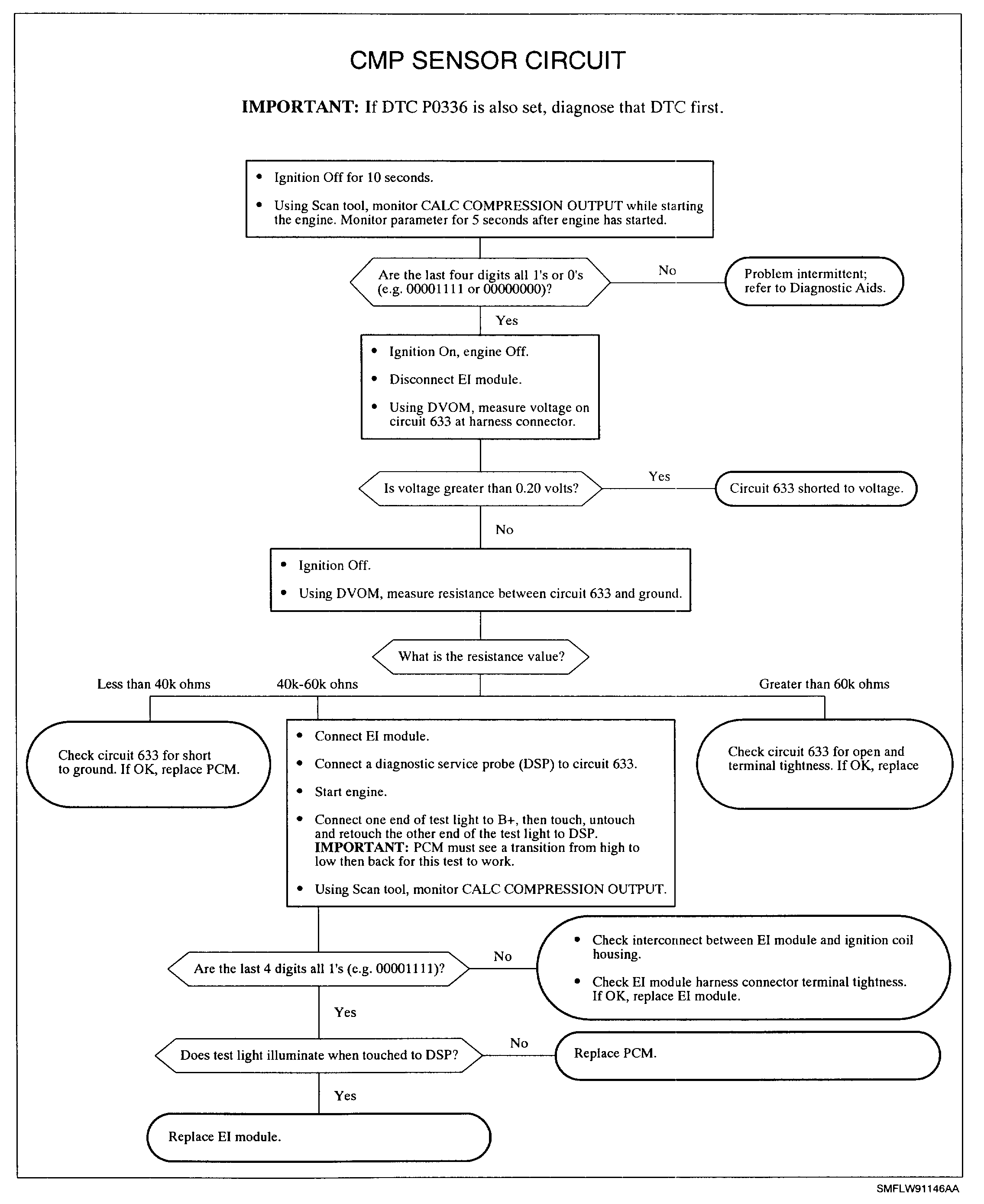

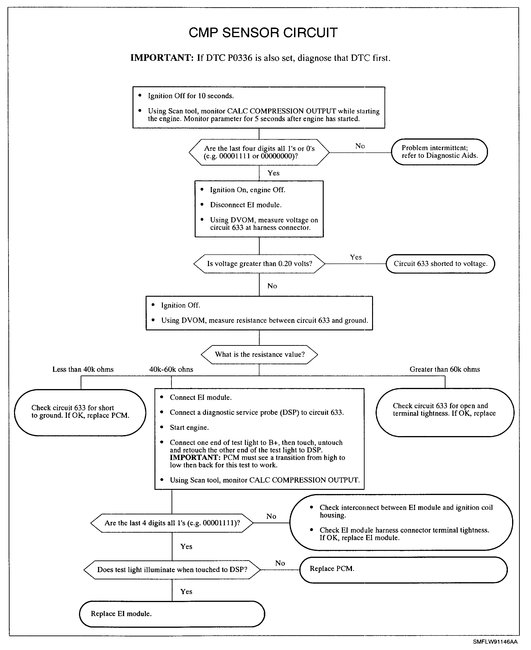

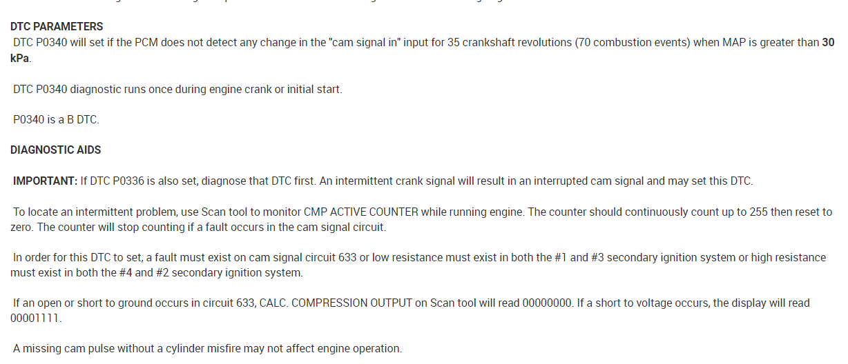

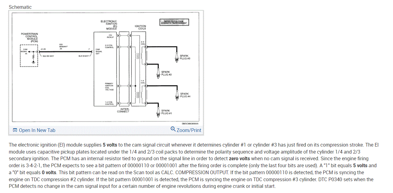

Here is my concern: If the CSI isn't recognizing a compression stroke, it will cause this code. When I think that you could have excessive blow-by, that could be a good indicator that compression is low. When I say blow by, I am referring to how much pressure is in the engine. That could be caused by worn piston rings or cylinder walls. Either of those could allow excessive compression to bypass the rings and end up in the crankcase. That could be the cause of the oil cap issue.
What I would suggest at this point is to check engine compression. If it is exceptionally low, I believe we found our problem. Here is a link that shows how it is done:
Let me know what you find.
Also, if you look at the attachments below, I included the diagnostic directions and relevant pics for checking for a p0340.
