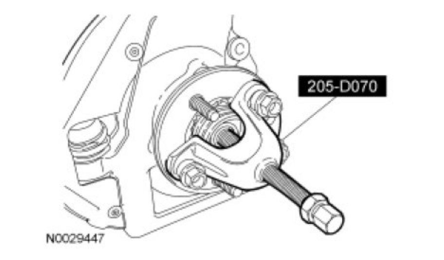

Procedure
Removal
NOTICE: Suspension fasteners are critical parts because they affect performance of vital components and systems and their failure may result in major service expense. New parts must be installed with the same part numbers or equivalent part, if replacement is necessary. Do not use a replacement part of lesser quality or substitute design. Torque values must be used as specified during reassembly to make sure of correct retention of these parts.
1. Remove the brake disc. For additional information, refer to Disc Brake System.
2. Remove and discard the wheel hub nut.
3. Using the Front Hub Remover, separate the halfshaft from the wheel hub.

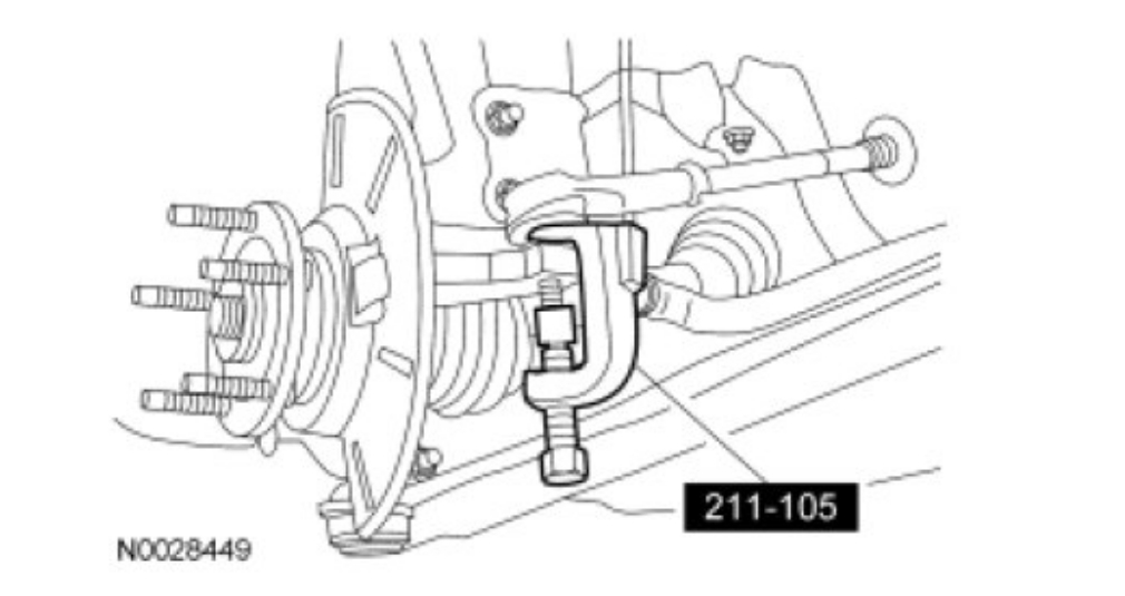

4. Remove and discard the tie-rod end nut.
5. NOTICE: Do not use a hammer to separate the tie-rod end from the wheel knuckle or damage to the wheel knuckle can result.
NOTICE: Do not damage the tie-rod end boot while installing the Tie-Rod End Remover.
Using the Tie-Rod End Remover, separate the tie rod from the wheel knuckle.
