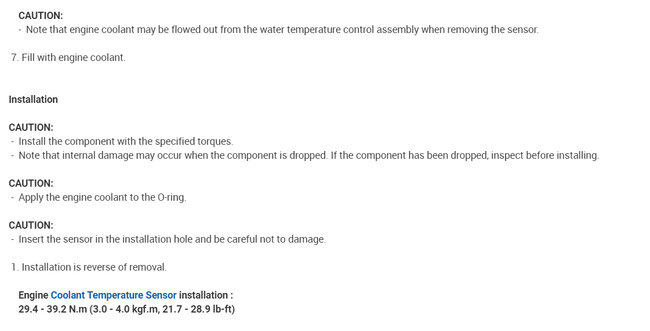

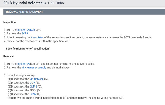

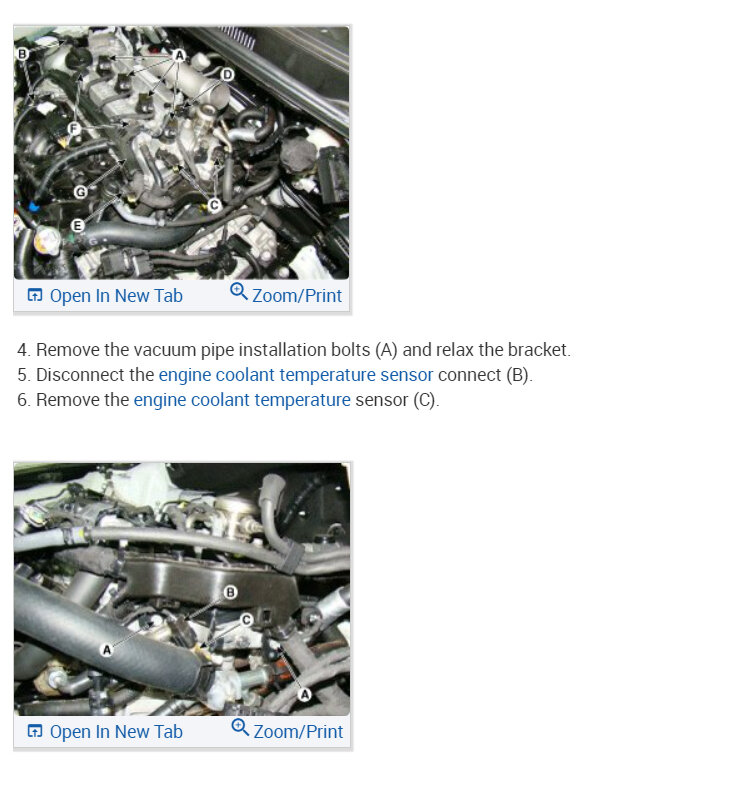

I have seen the engine coolant temperature sensor short out when hot which causes the engine is have problem starting and have weak power when it does, to be sure you can watch the sensor value on a scanner to confirm the issue.
Here is the location of the sensor in the images below. Please let us know what happens.
