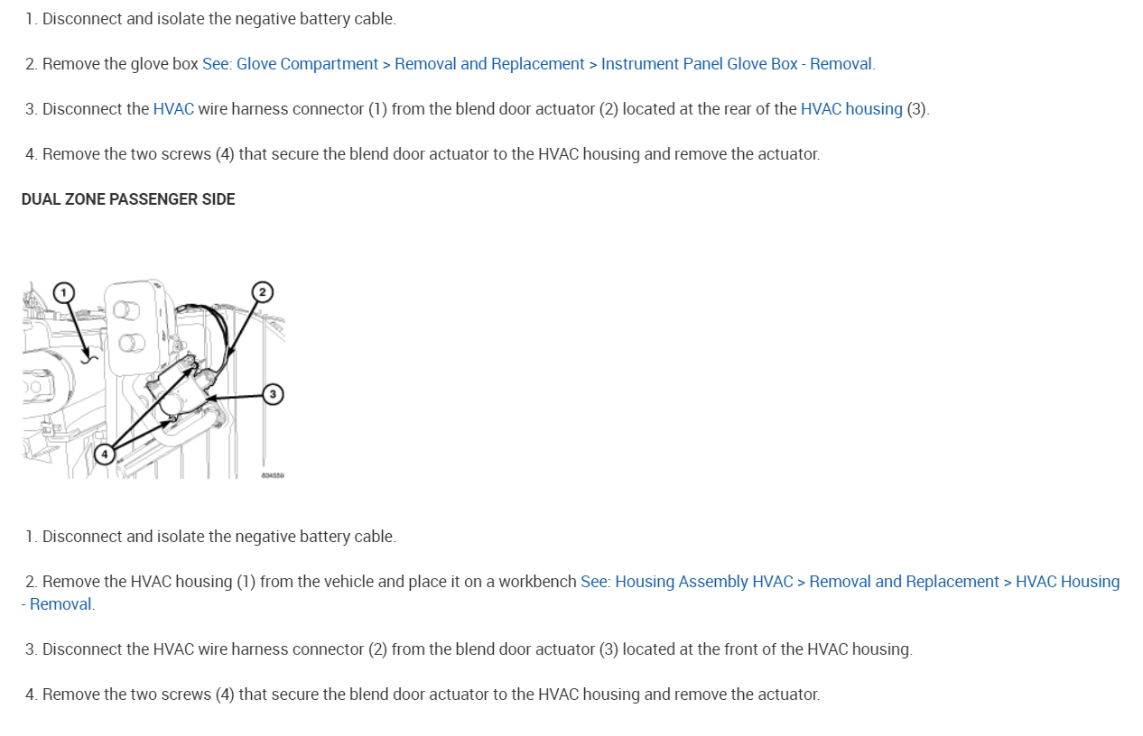

Have heat on passengers side vent cold on drivers side vent.

Okay. Couple more clarification questions. What do you have the settings on? Heat or AC when you are getting this. Also, is the vents on the far outside that are different or are the vents towards the center different as well?
May 1, 2019 at 6:26 PM
FRANK175
Two on each side the both right are hot both left are cold temp on hot I had the truck since bran new one side hot the other is cold
May 1, 2019 at 11:57 PM
  • 54,832 POSTS

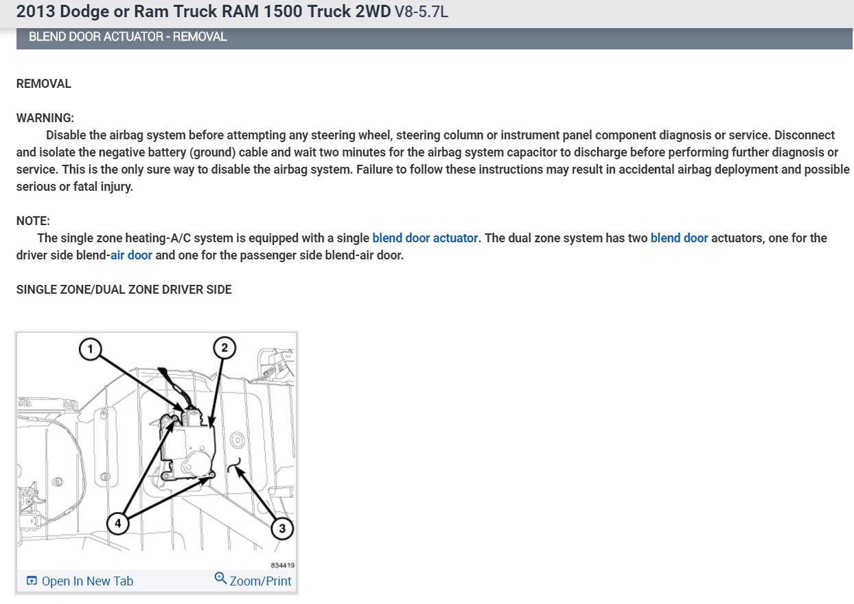

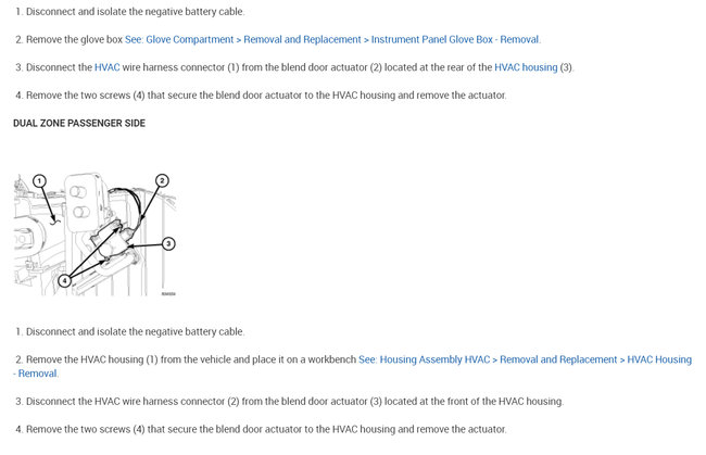

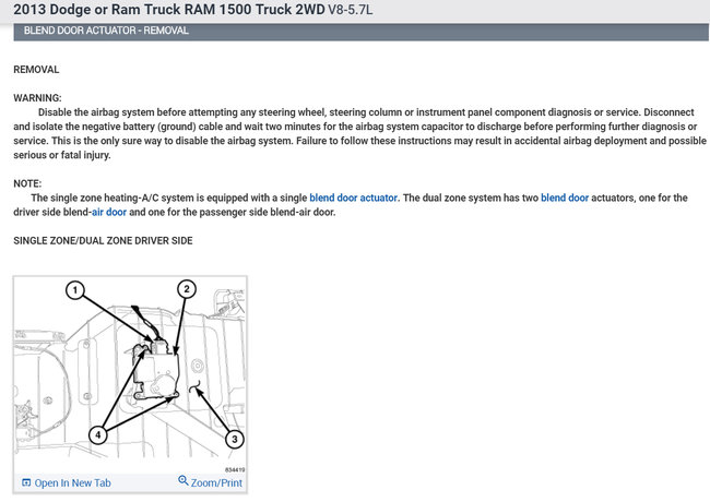

If I can jump in here, it sounds like you have a drivers side blend door actuator that is out. Here is a guide that will walk you through the steps with the location and instructions how to change it for your truck below.

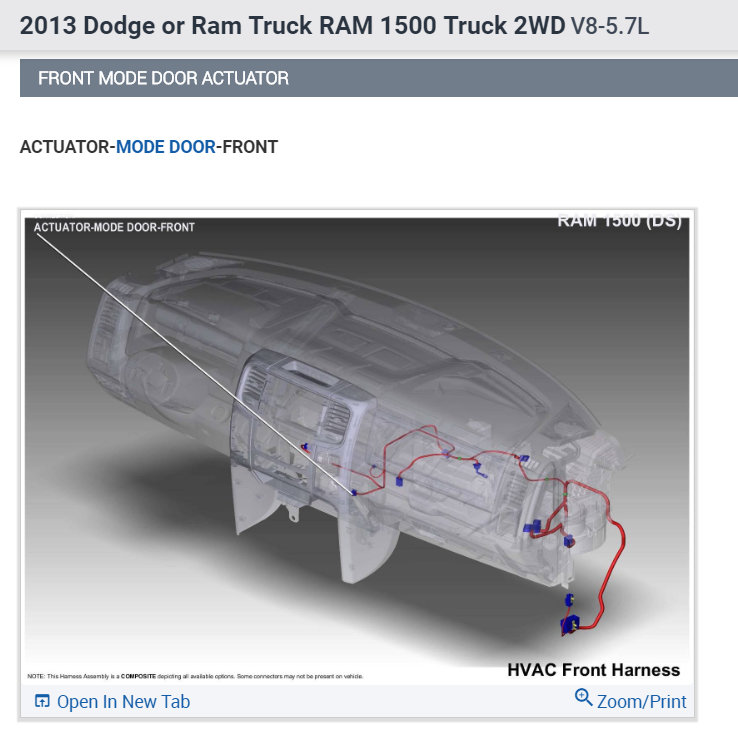

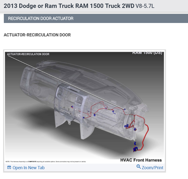

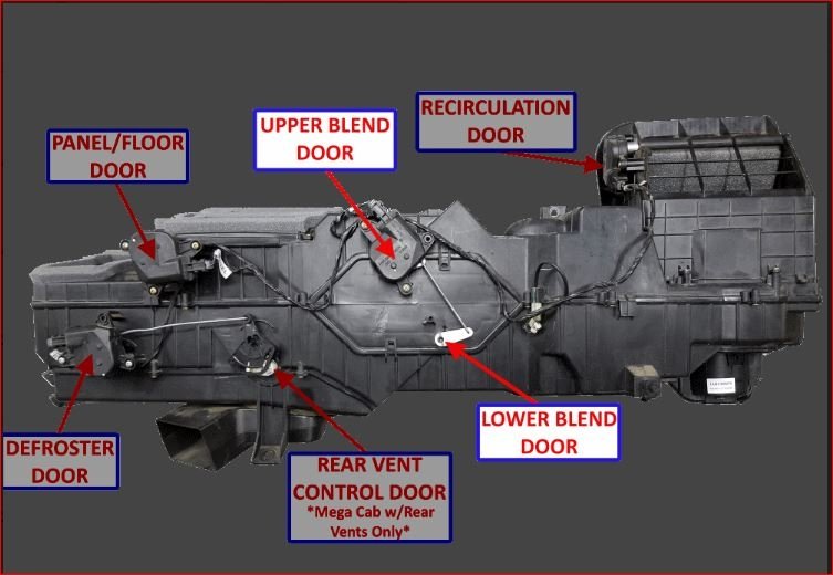

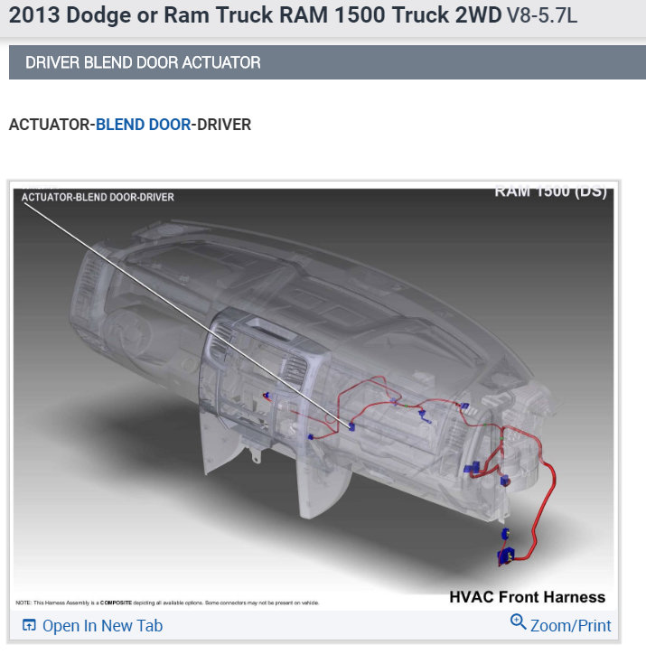

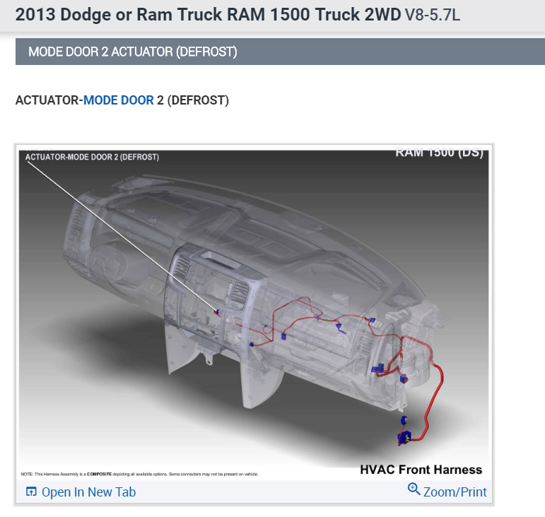

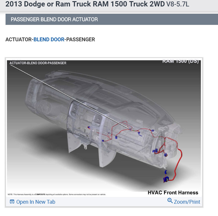

Check out the diagrams (Below). Please let us know what you find. We are interested to see what it is. I included all the blend door locations so you can see how the system works
May 2, 2019 at 11:35 AM
Thanks Ken.
Frank,
What you are describing is very common on dual temp zones and what Ken provided is correct. However, you said you have single zone so the principal of what Ken provided is correct. The only difference between a single zone system and a dual is the single has one actuator with a rod connecting to the second blend door and a dual has an actuator on both doors. However, the HVAC housing and everything inside is the same in both options.
If your driverside air temp is correct and the passenger side is wrong, I would suspect the rod shown in the picture either came off or the door is broken.
Let us know if you have any other questions. Thanks
