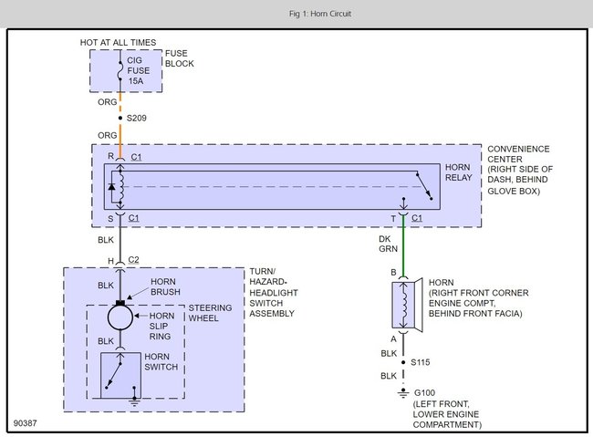

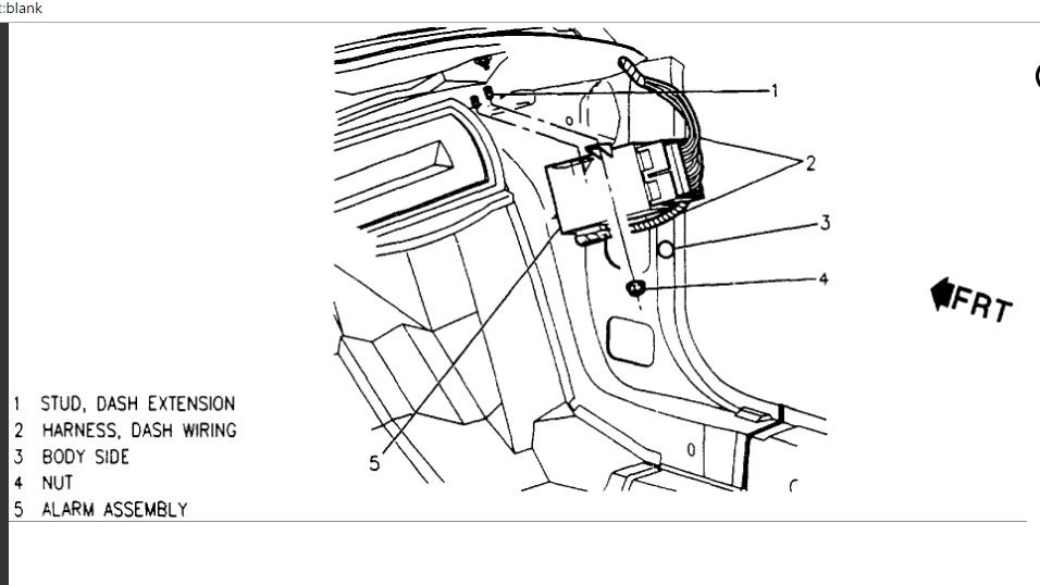

My horn is not working. we have checked the fuse and it is good. the horn itself is good (was tested). where is the horn relay switch located and how would i know if it is good or bad? I also have looked in my car manual for its location but it does not show its location or tell me where it is at for that matter.

I found this wiring diagram and location to help you find it. Here is a guide to help as well
