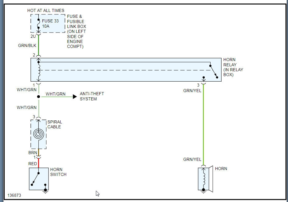

Replace battery clamps on terminals since then horn doesn't work. checked all fuses. went ahead and replace two, but that didn't work.
May 10, 2020 at 3:17 PM
Can you confirm that you checked fuse 33 for the horn? Then we need to remove the relay and take a paper clip and jump the relay from terminal 2 to 3. The horns should sound when you do it. If it does then the wiring from the relay to the horns and the horns work.
Next we need to install a known good relay (replace it), and then test voltage at pin one of the relay when you are pressing the horn.
Let me know what questions you have and we can figure this out. If all that was done was disconnect the battery and reinstalled, I suspect a fuse or relay issue but if those check out we need to work through the system an d see what we have.

Replaced two fuses, plus relay and horn still the horn doesn't work.
