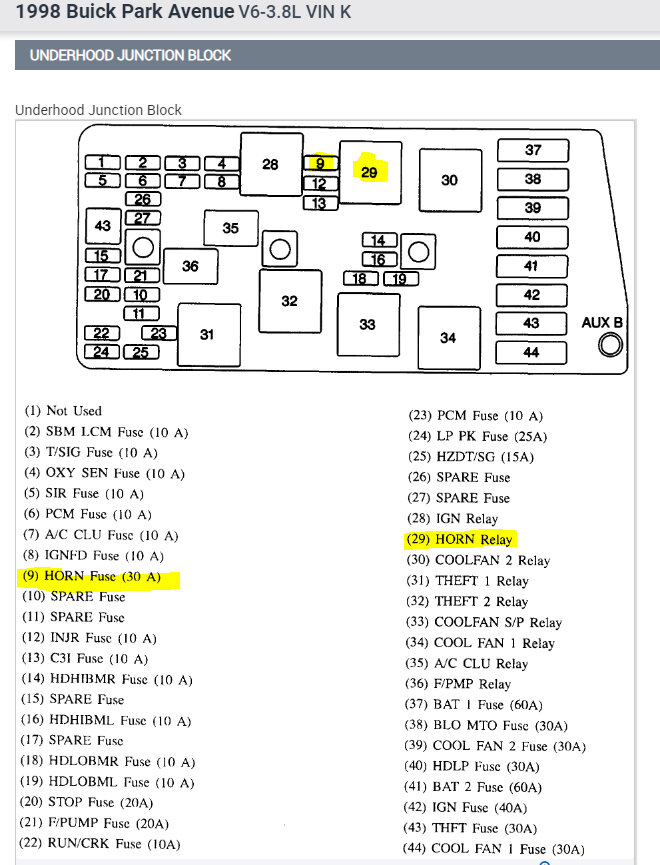

horn does not work when you push on steering wheel.

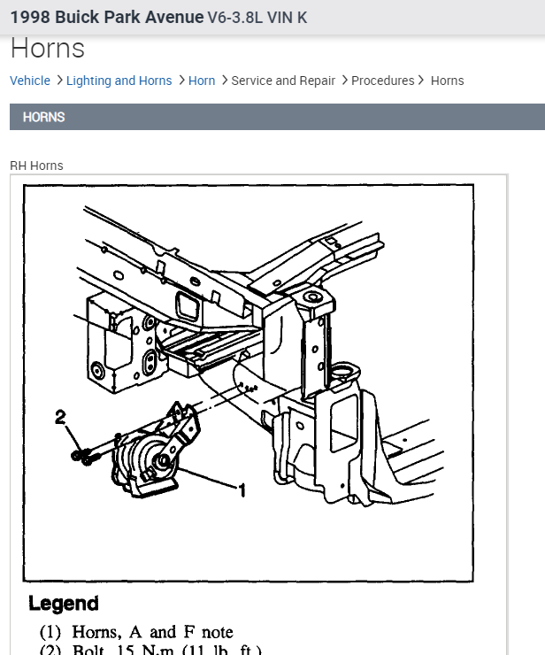

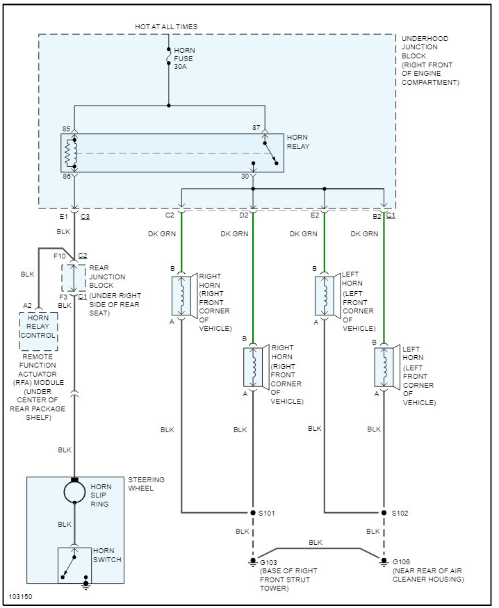

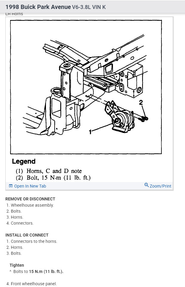

This could be due to a bad fuse, relay or wiring issue.
First you want to check the fuse for the horn.
It is located under the hood fuse block. If the fuse checks good, then the next step would be the horn relay. Which is also located in the same fuse blow under the hood.
Here are a couple of helpful guides:
I have attached the wiring schematics and the fuse block diagrams below for your reference.
Let me know what you find or if you have any questions.
