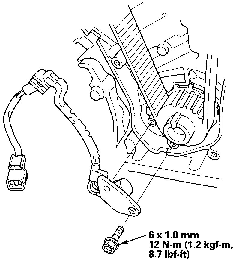

It does sound like a crankshaft position sensor. When they start going bad, heat can have an adverse affect on it. Take a look through these links.
https://www.2carpros.com/articles/how-a-crank-shaft-angle-sensor-works
This is the tough part. The best way to check if it's bad is using a live data scanner. When it won't start, you need to see if there is an RPM signal. If there is no signal, then my first suspect is always the sensor.
If you do this and find it is bad, here are the directions specific to your vehicle for replacement. The attached pictures correlate with the directions.

CKP SENSOR REPLACEMENT
1. Move the auto-tensioner to remove tension from the alternator belt, then remove the alternator belt.
2. Loosen the adjusting bolt, locknut and mounting bolt, then remove the Power Steering (P/S) pump belt.
3. Remove the dipstick and tube.
4. Remove the crankshaft pulley.
5. Remove the upper and lower covers.
pic 1
6. Disconnect the CKP sensor connector, then remove the back cover.
7. Install the CKP sensor in the reverse order of removal.

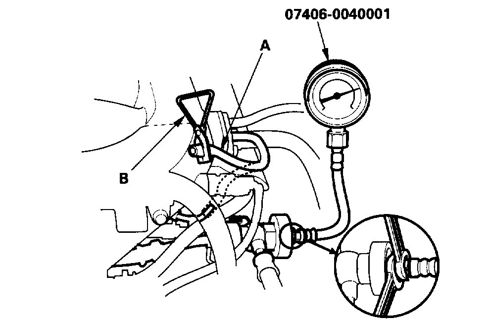

pic 2

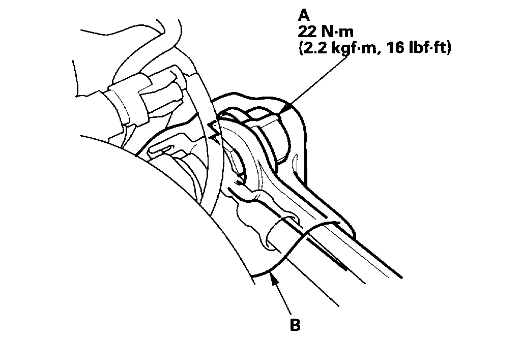

4. Use a wrench on the fuel pulsation damper (A) at the fuel rail.
5. Place a rag or shop towel (B) over the fuel pulsation damper.
6. Slowly loosen the fuel pulsation damper one complete turn.

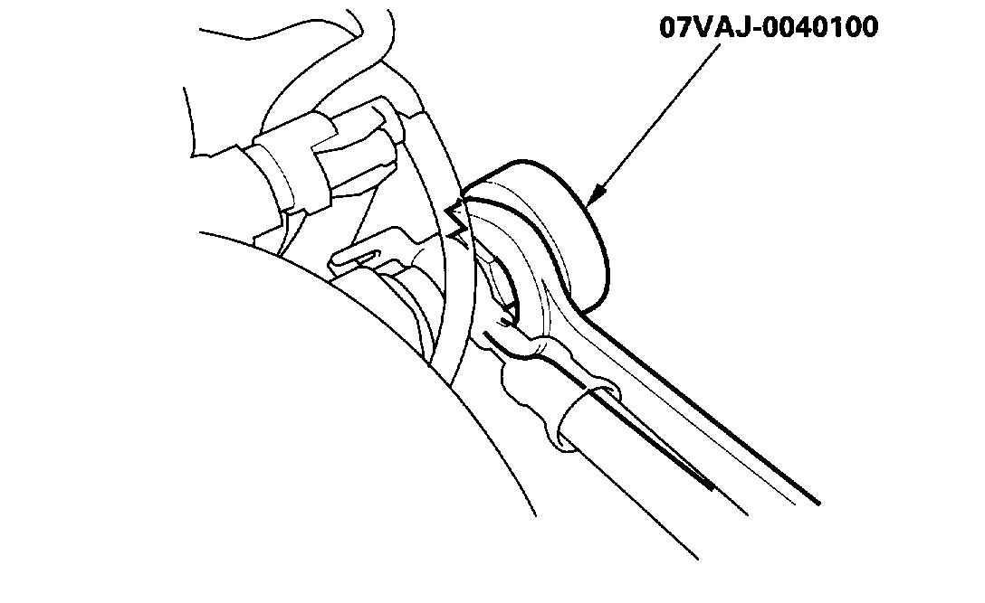

pic 3
7. Remove the fuel pulsation damper from its fitting, and attach the fuel pressure gauge attachment.
pic 4
8. Attach the fuel pressure gauge.
9. Disconnect the vacuum hose (A) of the fuel pressure regulator and pinch it closed with a clamp (B).

11. Check to see if the fuel pump is running: remove the fuel fill cap and hold your ear to the fuel fill port while an assistant turns the ignition switch ON (II) you should hear the pump run for about two seconds when the ignition turned ON (II).
- If the pump runs, go to step 12.
- If the pump does not run, test it .
12. Read the pressure gauge (with the fuel pressure regulator vacuum hose disconnected and clamped). The pressure should be 280-330 kPa (2.9-3.4 kg/Sq.cm, 41-48 psi).
- If the pressure is OK and engine is running, go to step 13. If not running, repair the cause, then continue this test.

15. Reconnect the vacuum hose, remove the pressure gauge, and reinstall the fuel pulsation damper and a new washer.Tighten the fuel pulsation damper to 22 Nm (2.2kg.m, 16 lb.ft).
