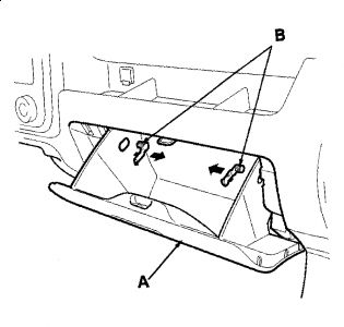

I found a few posts on dropping the glove box on earlier models; this doesn't seem to apply to the 09 model. There are no stops and as close as i can tell you would have to unbolt it.
Is this even where the filters are on this model?

yep, it's still behind the glove box. you open the box then remove the damper and glove box stop on each side, then let box hang down. then just remove the filter and replace..
https://images.2carpros.com/forum/automotive_pictures/261618_Graphic_419.jpg
https://images.2carpros.com/forum/automotive_pictures/261618_Graphic2_63.jpg
