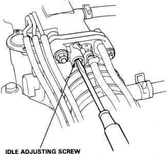

Try adjusting the idle speed thru here
https://www.2carpros.com/forum/automotive_pictures/12900_honda_7.jpg
Tuesday, October 12th, 2010 AT 10:28 PM
SQUIIZY
Razy; I have adjusted this screw right in with reves still high. I thought this was cutting down the fuel flow. Sorry; squiizy

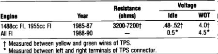

Did you double check for vacuum leaks-try checking the TPS sensor voltages-see below
https://www.2carpros.com/forum/automotive_pictures/12900_tps_30.jpg
Tuesday, October 12th, 2010 AT 10:46 PM
SQUIIZY
I will try all your suggestions. Thank you very much for your help. Squiizy.
