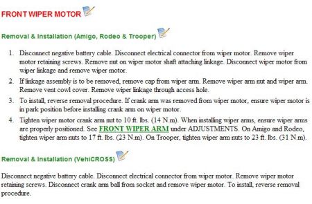

This just started this morning... my windshield wipers seems to have stopped working... I can manually move the left & the right moves with it... but when I turn them on, I get no movement, just the sound of the wiper motor... Help please...

Hi there, The regulator pivot more than likely has failed, i will look up the procedure to replace this if you want to do it, or just get your mechanic to inspect the wiper regulator, that is also part of this system.

Hi there, I found this on wiper motors, but i can't find anything on the regulator, but normally if you undo the wiper arm, and the pivot retaining nut, the regulator will with draw out the opening for the motor as well, but check the motor pivot first. There were no pics of this operation, sorry. mark (mhpautos)
