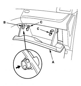

need more photo and drawings instructions in removing clove compartment

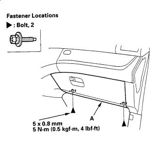

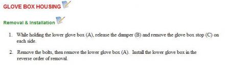

Thank you for your response. On the drawings provided; I have no problem
removing the damper (B) however, I'm having a hard time figuring how to
remove the glove box stops (C) since there is no clips or spaced enough to
get a clear view of the box stops. I assuming that my 2006 Odyssey EX-L
model is similar to the one shown in the video. What am I overlooking or
doing wrong? Thank you again.
Jan 25, 2010 at 9:28 AM
BLUELIGHTNIN6
  • 16,542 POSTS
To remove the stops, pry inward on the tabs inside the glovebox.
As an alternative to removing the two door stops in the glove box, you can also remove the two 8 mm screws at the bottom and work the entire glove box out of the dash. This also allows the contents to remain inside the box (useful if its full of stuff).
