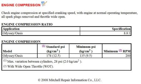

well i replace fuel pressure regulator and swap injectors. the only thing i didnt replace was the ignition coil you think it could be the coil?
anyway im gonna loan a compression tool. my other question is whats the compression ratio for my car should be? thanks in advance

If it is the coil, it would affect all other cylinders as it is shared by them. Hee are the details for the compression.
https://images.2carpros.com/forum/automotive_pictures/192750_Compression97Odyssey_1.jpg

well this is my readings on the cylinders
#1 is 60 #2 is 135 #3 is 135 #4 is 130
i put some motor oil on #1 after my first reading and the gauge on the tester goes crazy.
my question thats means is the piston rongs or the valves? thanks for all your help...

If the pressure shoots up after putting in some oil, the rings are bad.
Valve leaks would result in not much changes if you do a wet test, ie after you put oil into the cylinders. Check the valve clearances.
If the engine had been left sitting over an extended period of time, the wet test might get the engine running and the problem might cure itself when the rings starts working again.
