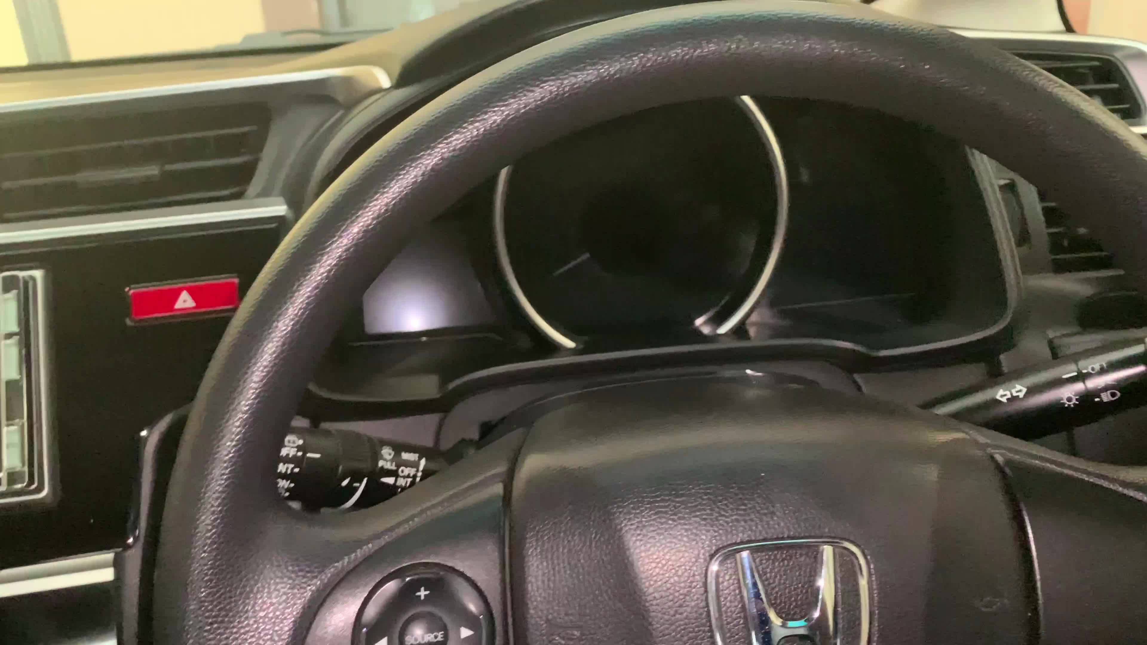

Car won’t startup using push button and I get following error codes
However, the aircon and multimedia player turn on but won’t get ignition lights and won’t get started instead the car keeps asking to press brake and push start button.
Error Codes:
U0155 F-CAN Malfunction
U12AD EPP(IMA)-CAN Malfunction
U0293 Malfunction (ECM-PCM-Motor)
Solutions I have tried are below:
Replacing new push start button.
Replacing 12v main battery.
Replaced the remote battery.
Also confirmed that when pressing brake pedal the rear brake lights turn on.
See the attached video
The car listed above is an AWD, GP-6.

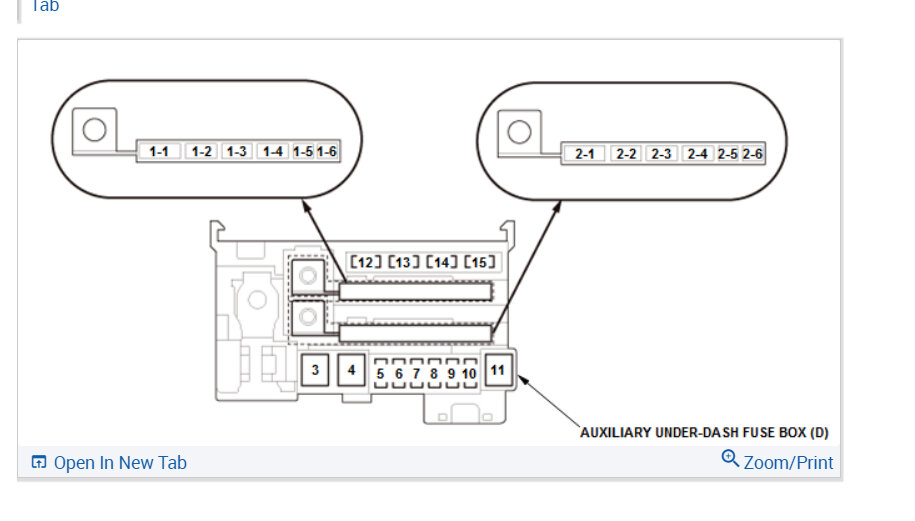

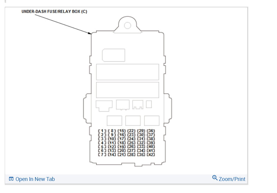

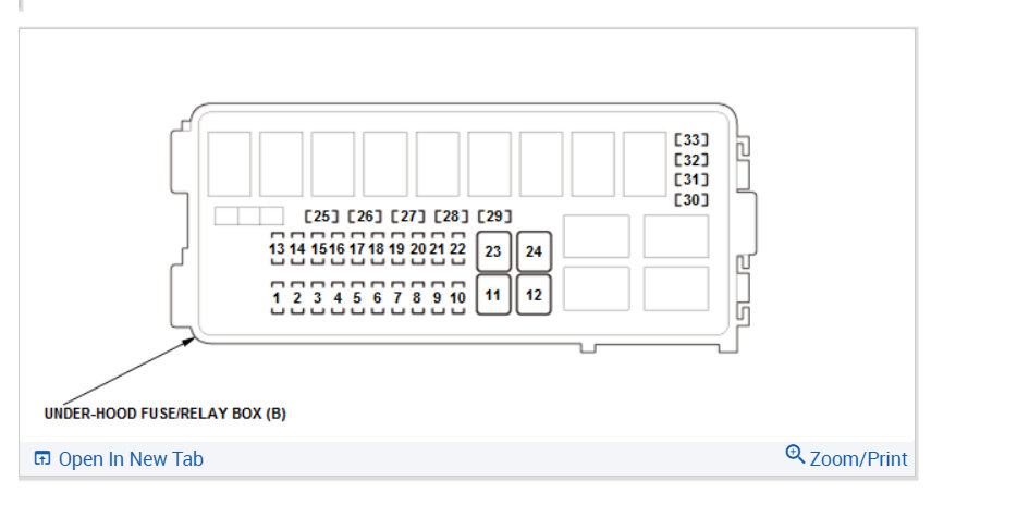

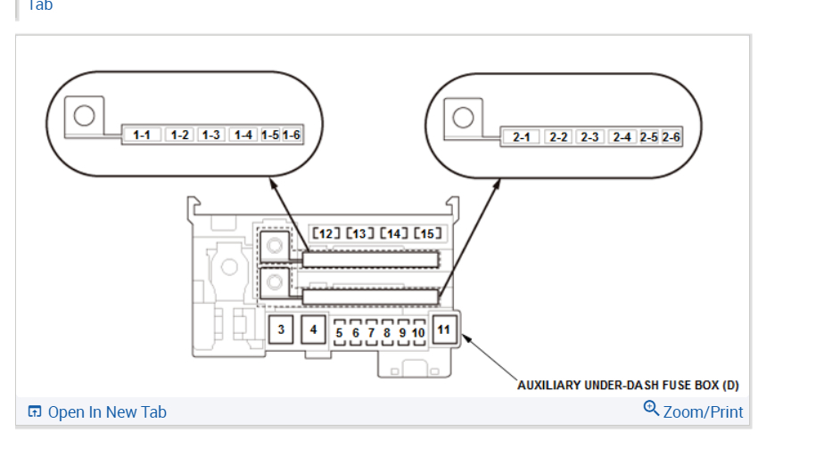

Thanks for the video and images. I would first check all fuses when the system is on. This guide can help.

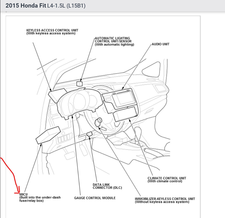

You may have a MICU that needs to be replaced. Check out the images (below). Let us know what happens and please upload pictures or videos of the problem so we can see what's going on.

I called in a technician from Honda, and he disconnected the main speedometer grip and tried starting the engine and it started
After that he turned off the engine quickly and reconnected the grip and tried started it again and it started. Then he turned the engine off and removed the error code with standard procedure with the scanner device
He suggested that the meter is faulty and need replacement and I don’t buy that.
Before preforming any of the things above he checked all the fuses which were all in healthy condition
What else do you suggest other than replacing the MICU after above diagnosis?
