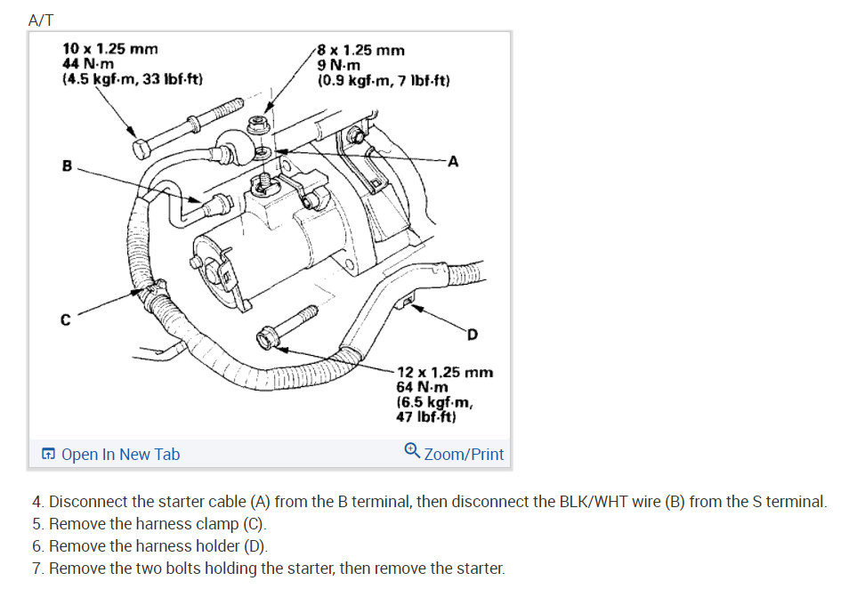

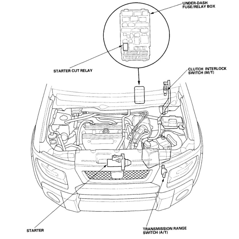

where is the starter located and how hard is it to get out?

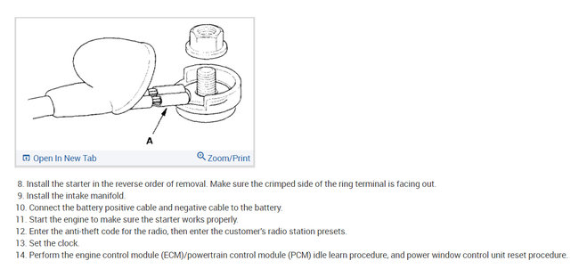

Starter is located bottom rear of engine. Just follow positive battery cable, it leads straight to it. Here is a guide to help you step by step with instructions in the diagrams below to show you how on your car.
Check out the diagrams (Below). Please let us know if you need anything else to get the problem fixed. Thanks for using 2CarPros.com!

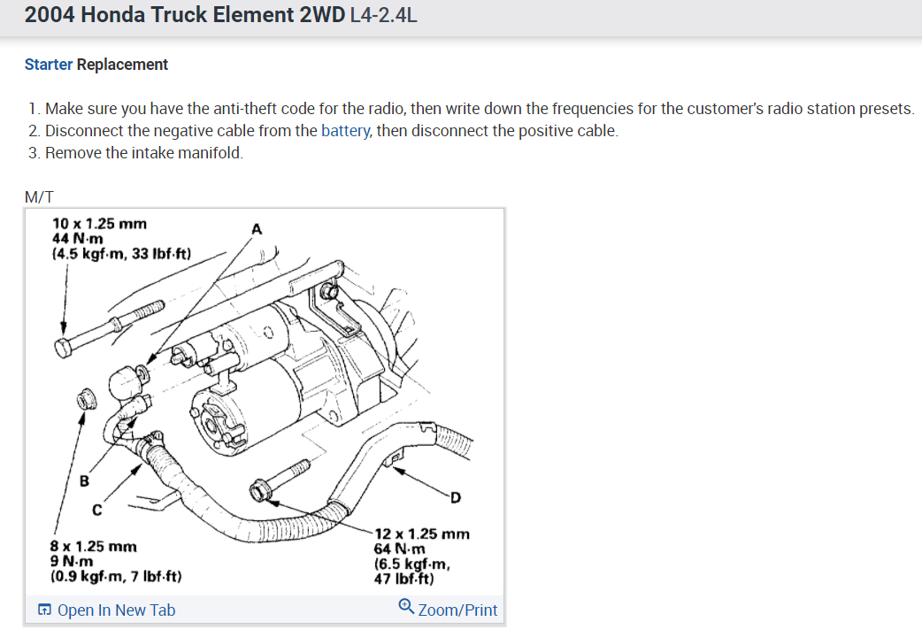

i cannot locate the starter on my 2003 honda element and does it look like a normal starter

[quote:94699d05db="moorewalter"]Engine Mechanical problem
2003 Honda Element 4 cyl Two Wheel Drive Automatic 108000 miles
i cannot locate the starter on my 2003 honda element and does it look like a normal starter[/quote:94699d05db]it is under the intake manifold.

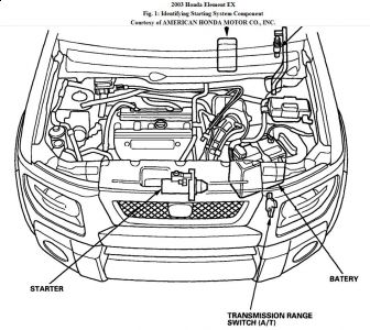

i cant find the starter

Hi there, Check out the diagrams (Below). Please let us know if you need anything else to get the problem fixed.
