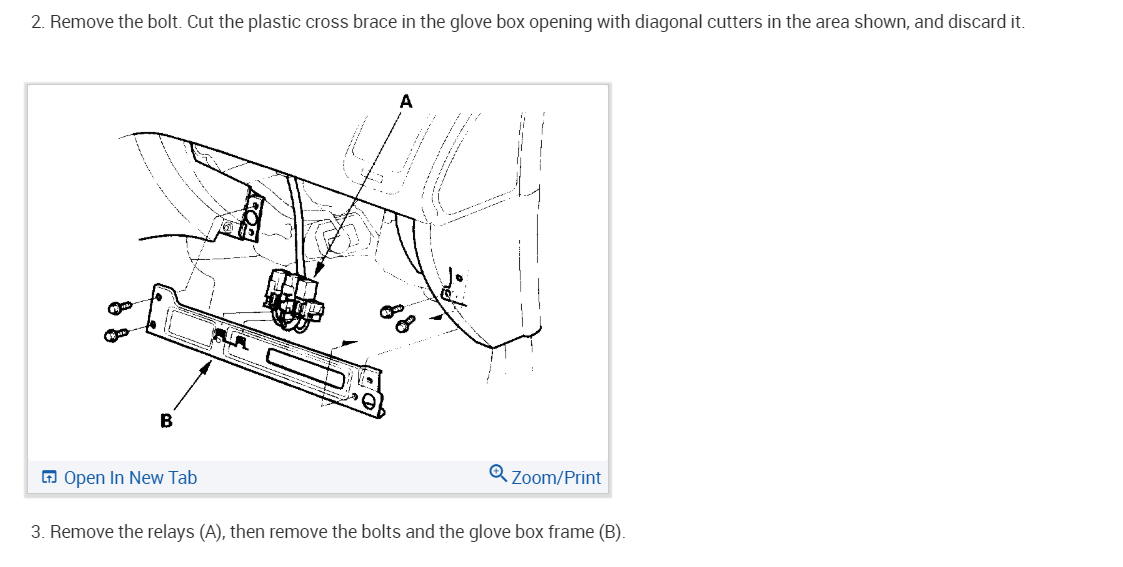

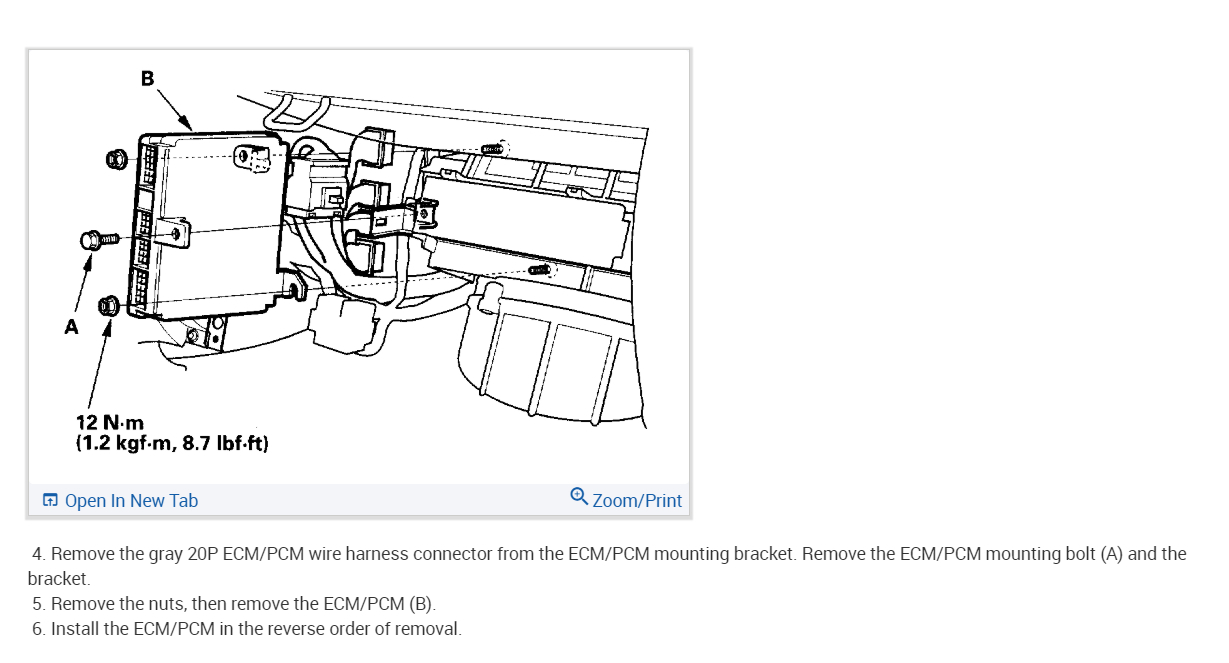

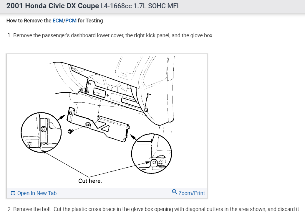

The Electronic Control Module of my car listed above (LX) is fried and un-repairable; confirmed by an ECM repair shop. I know that I must now either get the matching key and switch for the used replacement or get the new one reprogrammed.
The repair manual says the replacement must be the same part number, but
the original part number is 37820-PLM-315.
I see in several online new parts listings that the -315 is referred to as a "replacement" for the 37820-PLM-L01 and 37820-PLM-L02.
Question 1: Can I replace the *-315 with a *-L01 or *-L02 without ill effects?
Question 2: What is the opinion from a mechanic who has replaced a similar old ECM about the advantages of:
A) Replacing only the ECM (new or refurbished) and having it reprogrammed to match existing key, or,
B) Replacing the ECM with a guaranteed used or refurbished unit with matching key and ignition lock.
I need an authoritative answer from a Honda mechanic who has done it many times. Because the 100% correct information means money to me, I’d be willing to pay for wise, experienced advice, rather than a pretty-good educated guess (although I’m open to all informed opinions).

Thanks for the question as far as the part numbers go there will be few Honda parts guys that know off one will work in place of the other. The numbers must match or have an update. Can you find a used unit and have it programmed by a shop for about $130.00? Also rebuilt unit have great success as well. Here are instructions on how to change out the ECU. I am looking at the instructions on how to change the ECU they do not mention reprogramming I think it is plug and play. Check out the diagrams (below). Please let us know what you find. We are interested to see what it is.
