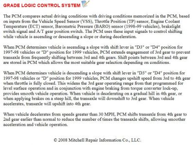

My 98 crv needed a transmission repair. The car drove great but the 2nd gear was slipping. After the rebuilt transmission (a Precision product, I believe when I was verbally promised Honda parts), the car shifts late with an increase in engine rpm. It is not much but very noticable and makes the job unacceptable. My mechanic, who said everything was good before the work was done including the engine, tried to tell me that the engine had an issue now and that ALL Hondas shift late. How can we resolve this in the best interest of all parties concerned? Please help me fix this.

Hi webrlamy, If the trans has no issues such as harsh shifting, slipping, delayed response, it should be ok. Here is a description of the trans operations which employs a grade logic control system.
https://images.2carpros.com/forum/automotive_pictures/192750_GradeLogicHonda_1.jpg
Under normal circumstances, the shifting would be governed by throttle opening, vehicle speed and engine performance. If the engine has any issues, the timing for the shifting might be delayed as it is taking longer for the vehicle speed to build up. Since your mechanic mentioned an issue with the engine, it could be possible and you should have a look at it.

That could explain the late upshift. Lower speed sensing means the PCM is receiving a slower signal.
Possibly the trans was exchanged and the gear ratio might be different. Usually rebuilts means they would take your tran in and give you one they had rebuilt beforehand.
How did you gauge that your speedometer is 4 mph slower?

So guess the problem should be the trans speed sensor or might be a different gear ratio than originally was.
You can get back to the trans shop and explain this to them and see if they can come up with anything.
