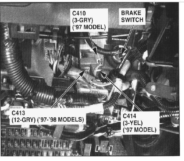

After I turn off my car, my rear brake lights won't turn off. Every once and a while they will turn off when I restart the vehicle and then turn it off again. I'm not sure if it's relevant, but I just changed my battery.
Any suggestions you have would be greatly appreciated.

It sounds like the brake light switch is broken and needs replacement. It is located by the upper part of the brake pedal and will take about 20 minutes to replace. You can get a replacement switch from Amazon.
Here is a diagram of the switch (BELOW). Try unplugging it first to see if the lights go out.
Please let us know what you find ;)
