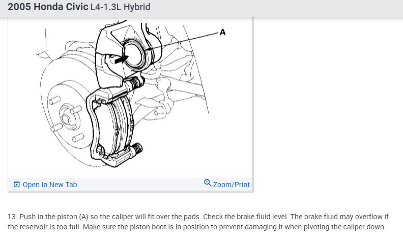

I'm told I have to replace the front brakes
Tuesday, July 7th, 2009 AT 6:07 PM
SQM
  • 6,383 POSTS

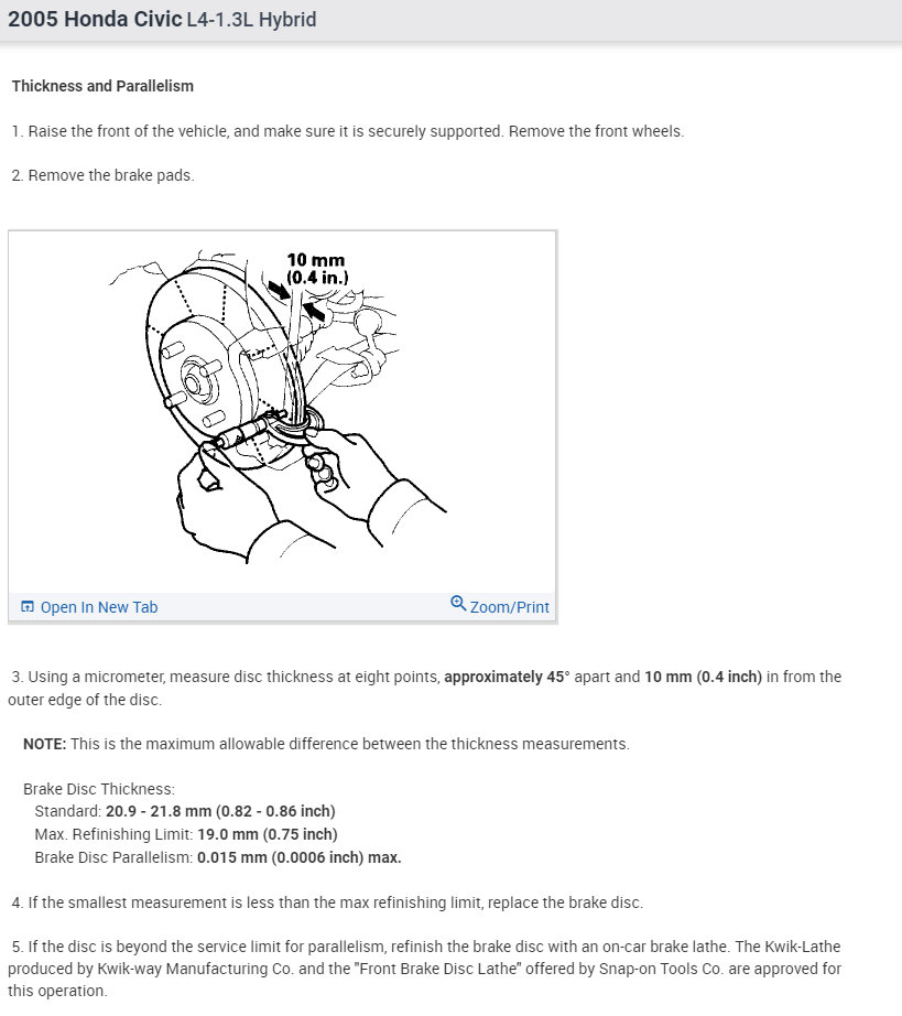

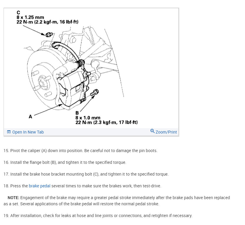

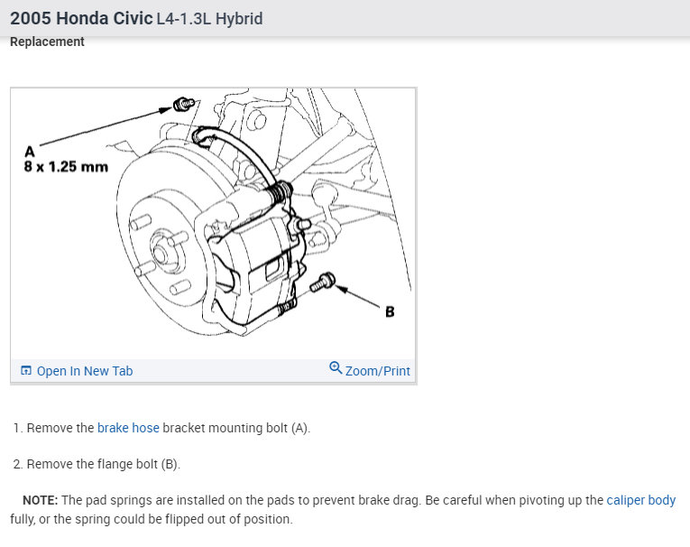

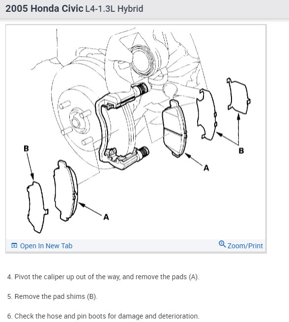

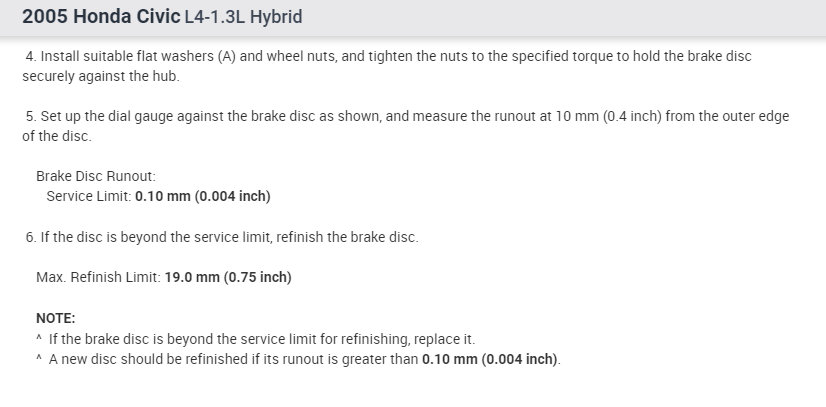

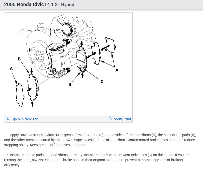

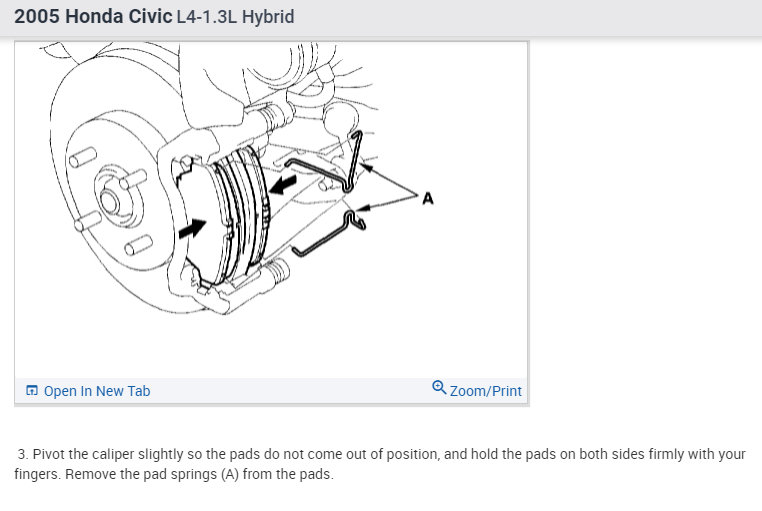

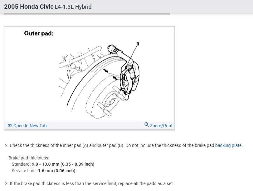

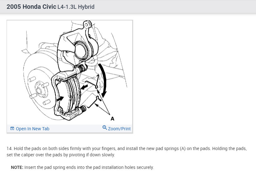

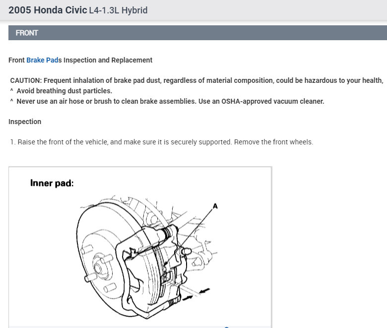

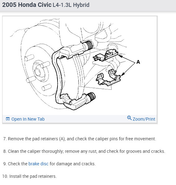

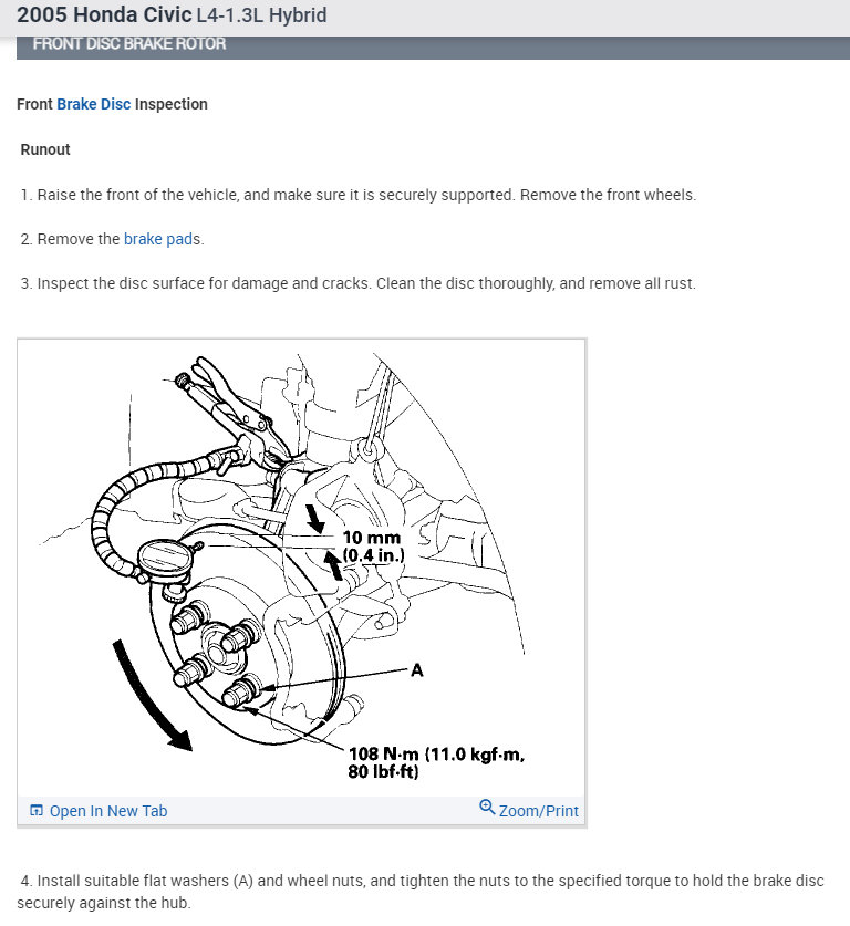

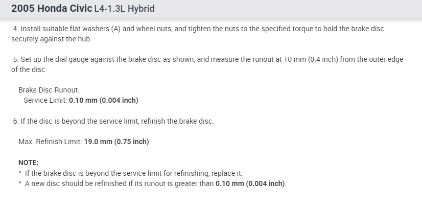

Replacing the front brake pads can be done easily with using basic hand tool on this vehicle.
Keep in mind anytime the brake pads get replaced, it is recommended to resurface the rotors (if they are within specification). If they are below minimum thickness, it will be required to replace the rotors as well.
Here is a helpful guide:
