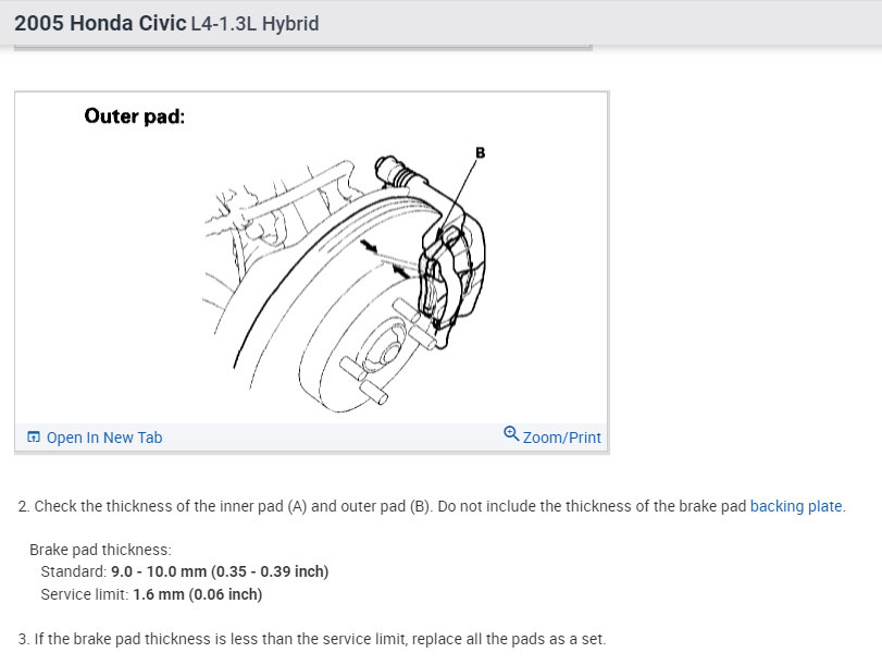

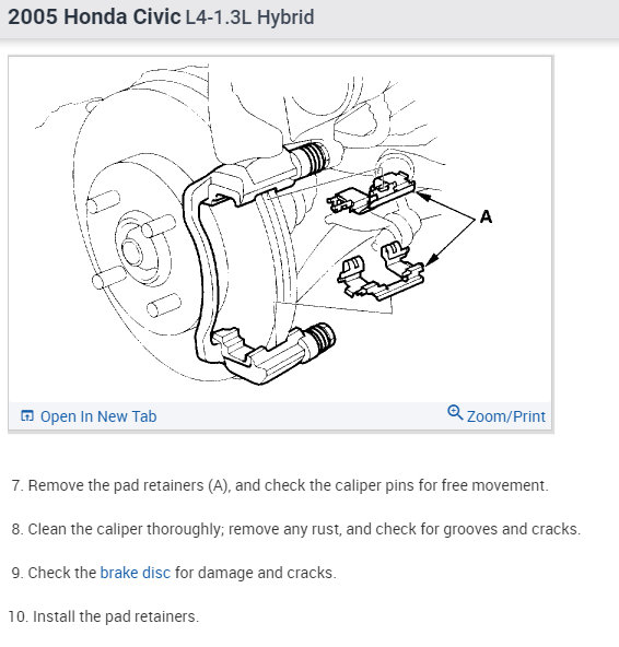

When I am driving in snow or rain, my brakes occasionally make grinding noise from the front
Dec 14, 2009 at 1:41 PM
SQM
  • 6,383 POSTS

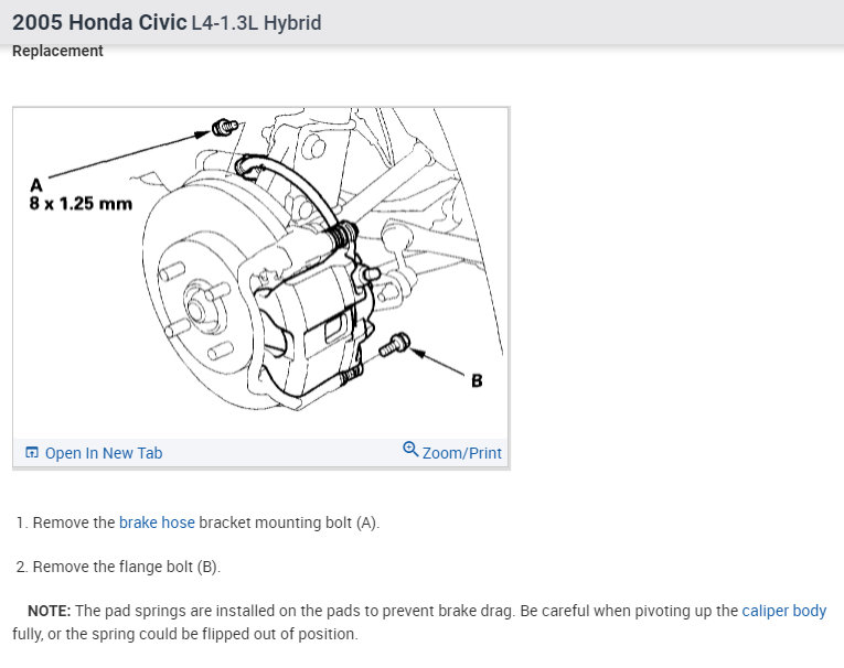

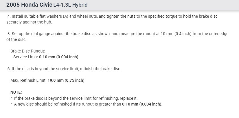

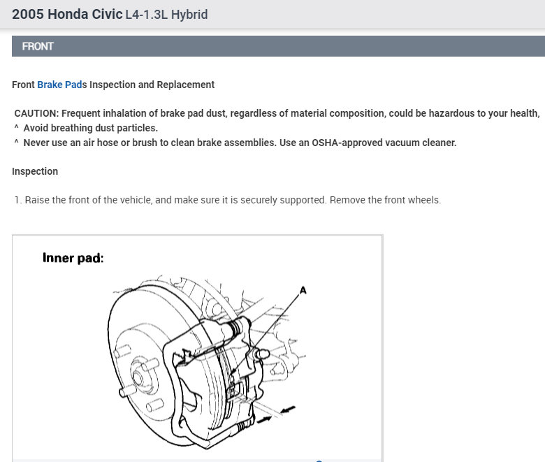

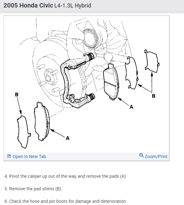

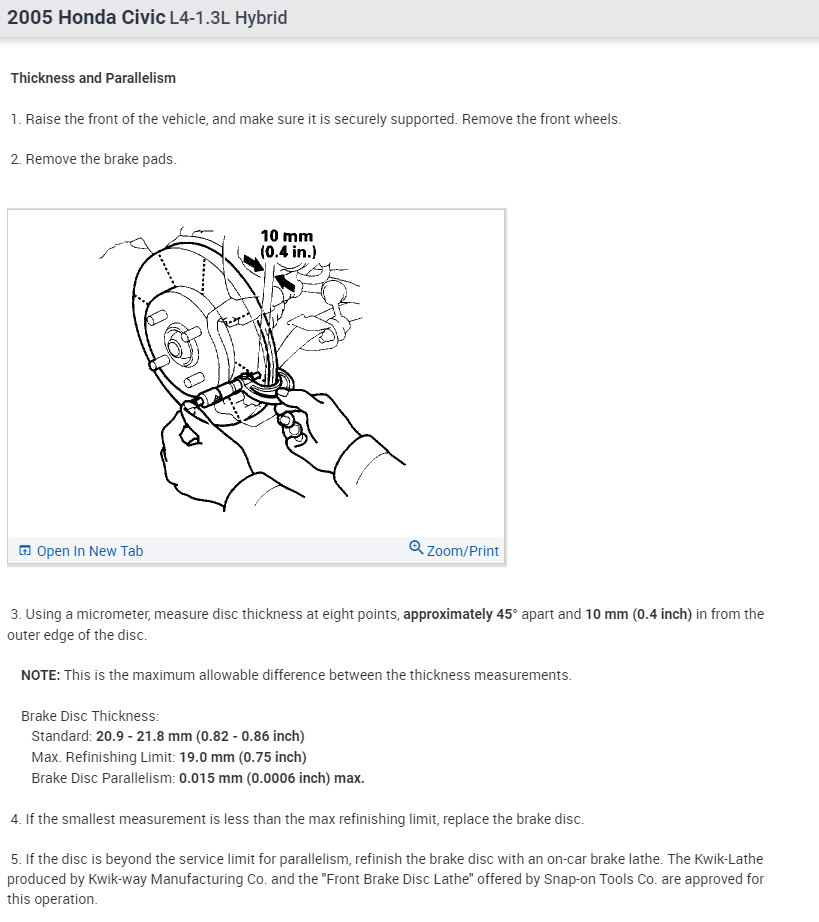

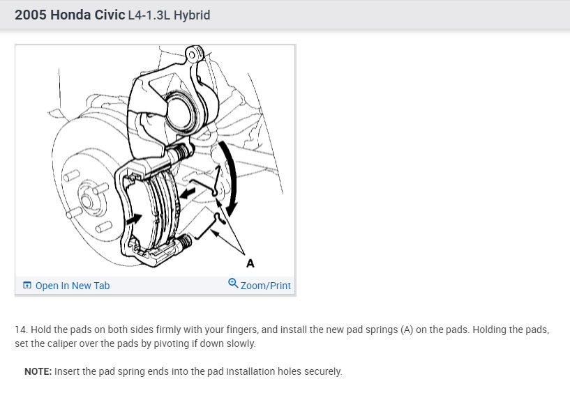

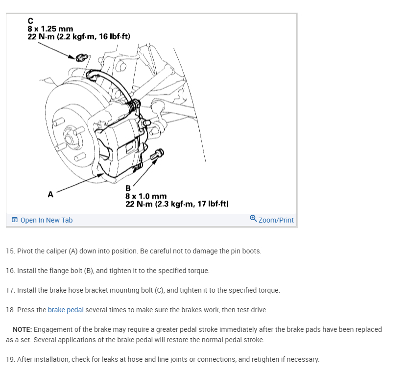

This could be due to worn brake pads. It is possible due to moisture in-between the pad and rotor creates the noise since the components are worn.

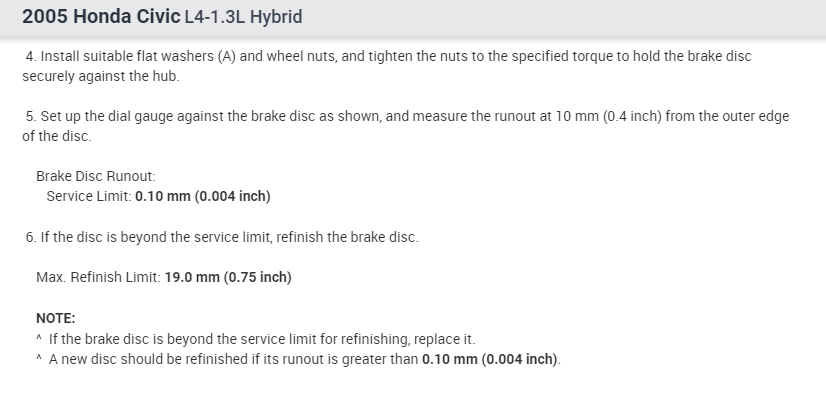

Replacing the brake pads and resurfacing the rotors (if the rotors are within in specifications), should take care of this issue.
If the rotors are below specifications, they will need to be replaced.
