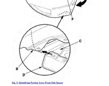

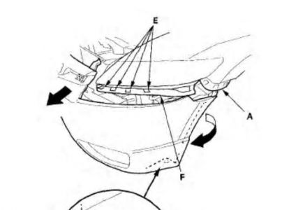

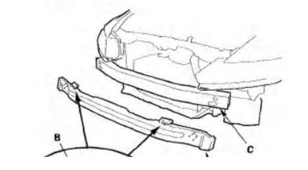

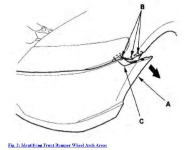

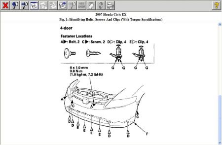

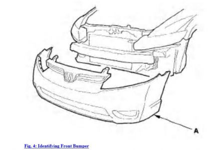

Is it fairly easy and worth it to replace a front bumper on my own. No damage was done other than to the bumper which cracked very easily.

Hi gdrouin, To replace the bumper it is not that difficult. FRONT BUMPER REMOVAL/INSTALLATION NOTE:  Have an assistant help you when removing and installing the front bumper.  Take care not to scratch the front bumper and body.  Put on gloves to protect your hands. 1. Remove these items: Front fender trim Front grille cover 2. Remove the bolts (A, B), screws (C), and clips (D, E) securing the front bumper (F). NOTE: To remove the clips D and E, pry the inner clip up at the edge near the line (G) on its head.

3. Pull on the front bumper (A) at the wheel arch areas to release it from the hooks (B) on the side spacers (C).

4. With the help of an assistant, while pulling the wheel arch portion away from the side spacer (A) and the lower corner portion (B) away from between the front inner fender (C) and the front strake (D) (Si model 2-door), pull the front bumper to release the bumper from the hooks (E) on the upper beam (F).

5. Remove the front bumper (A).

6. Release the hooks (A) (4-door), then remove the front bumper absorber (B) from the front bumper beam (C).
