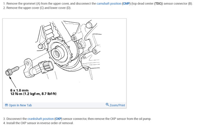

The car almost stalled yesterday and check engine light came on. I pulled up the code: P1361. Checked the sensor connection and everything looked fine. Reset the light and the car drives fine for now. Is it time for TDC sensor to be replaced or is there another cause for this?

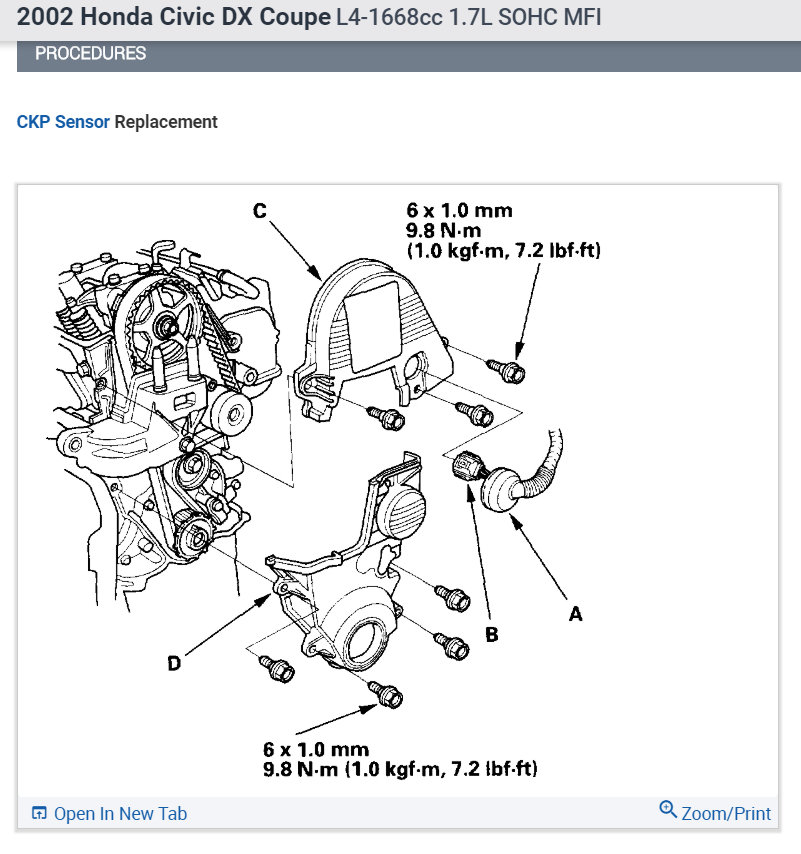

Hi Horiavese,
Yes this means the crankshaft position sensor is about to go out here are diagrams (below) to help you see what you are in for when doing the job and step by steps guides to help walk you through it.
Cheers

Thank you for this post I had this problem and the ensor fixed it cost me $78.00 fort the sensor all set!.... I love this site.
