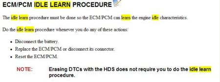

when i start up my car engine ( cold engine ) every thing is fine but after one minutes the engine is working more slowly ,so i need to give more gas if not the engine will shut off .after that the car is working perfec tly ...

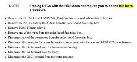

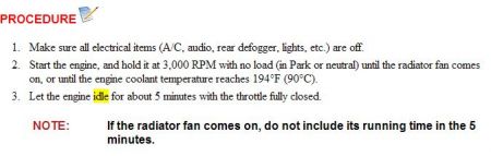

HI there, Thank you for the donation. You will first have to try the idle re learn procedure, the text below will give you step by step instructions, if in doubt get a mechanic to do this for you. Mark(mhpautos)
