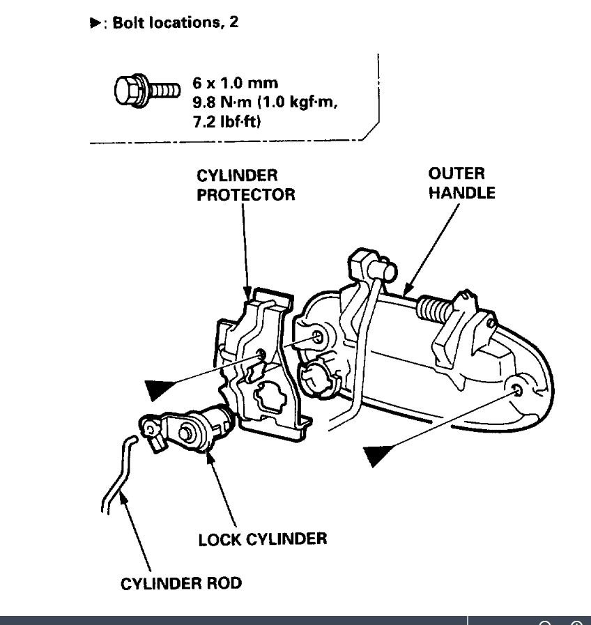

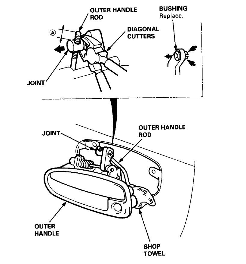

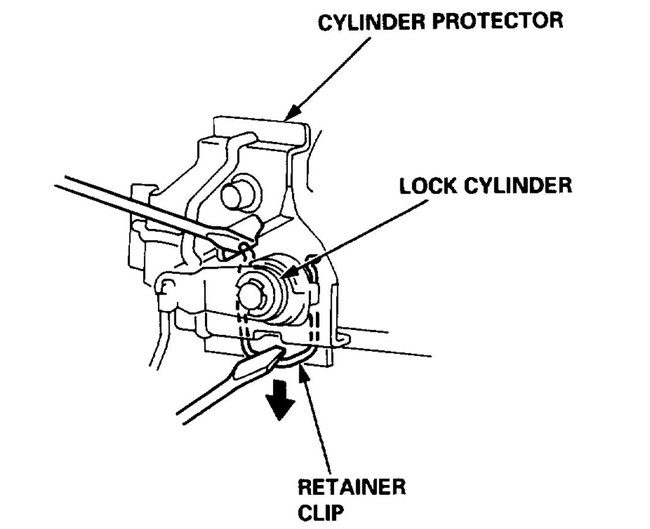

My driver side front door will not open. Lock moves up, but will not open.
Jun 4, 2008 at 10:48 AM
MHPAUTOS
  • 31,937 POSTS
Hi there,
You will have to remove the inner door panel to get at the lock mechanism. It either has a control rod or linkage that fell off or the latch is broken internally
mark (mhpautos)
Attached below are some diagrams of how the control rods attach to the latch assembly
