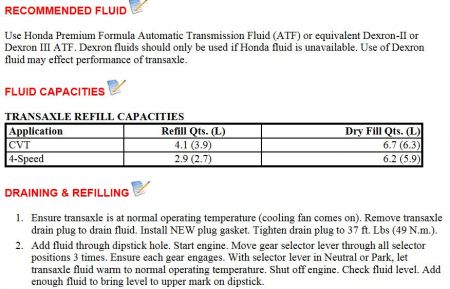

Good day sir, I have a honda civic LXi 96, just wanted to ask if going to change the ATF how many liters does it need to pour? 1 liter only or 2 liters? Thank you and looking forward to hear from you again. God Bless.
Sincerely,
Fern
Sunday, April 12th, 2009 AT 9:23 AM
KHLOW2008
  • 41,814 POSTS
Hi Fern,
Here are the details.
https://www.2carpros.com/forum/automotive_pictures/192750_ATFCpacities96CivicLX_1.jpg
Have a nice day
Sunday, April 12th, 2009 AT 10:04 AM
