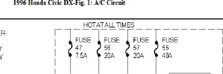

hi, i have a problem with my ac, the condensor fuse keeps blowing. when i first start the car with a new fuse, it works fine. then after like 5-10 min after the car is warmed up, the cooling fan turns on and pops the condensor fuse but the cooling fan is ok. i have replaced both relays and i have checked if the fans lock up or not and they are both fine. they spin easily with no problem.

Hi, can you please tell me which fuse it is?

um its the 20 amp condensor fan fuse only ,the cooling fan fuse is also a 20 but it never blows , thnx 4 the quick reply

For a quick and dirty troubleshooting method, try disconnecting each fan in turn and seeing if the fuse still blows.
