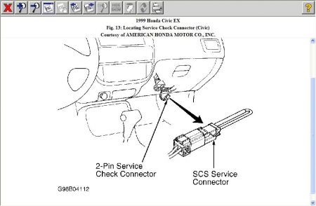

Hi way2fast20, The Check Engine Lamp. I suspect the Check Engine Lamp is caused by the speedometer not functioning but you need to confirm it by connecting the SCS to get into diagnostic mode and count the flashes of the Lamp blinking. A code of 1 long and 7 short flashes would be it.
https://images.2carpros.com/forum/automotive_pictures/192750_SCS99Civic_2.jpg
As to the speedometer not functioning, you might have broken one of the speed sensor wires near the connectors. You need to check for broken wires or loose connector pins.
