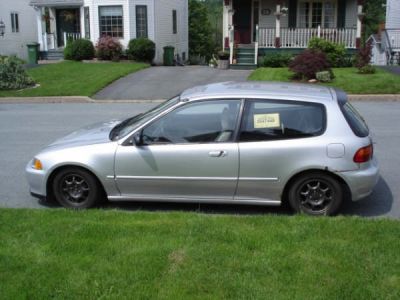

i was wondering if i could take the drivers door off that car and swap it with the one?
PUDIACHEE
Hi, I just bought a 1994 Honda Civic Hatchback DX two door, and the guy who had it before me was moving so the moving company backed there truck into the side of the car and the window and all the gear inside the door are bent out of shape and horrible. So I found a 1992 Hatchback civic and i was wondering if i could take the drivers door off that car and swap it with the one I have that is broken.[img:b3eb44bf25]http://www.2carpros.com/forum/automotive_pictures/125595_civey_poo_1.jpg[/img:b3eb44bf25]

These doors are interchangeable.
Just be sure to get a door that has the same function as your door. Make sure it has power or manual windows/locks exactly like your vehicle.
Be sure to have someone help you when the door gets removed. As the door can be heavy and awkward.
