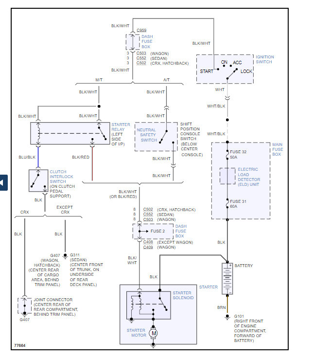

We have bought a 91 civic, unknowingly ripped off an "extra fuse hookup" attached to the wire and threw it out, to replace the battery with a new one. Now we cannot get a fire, without that "extra" fuse hook-up I guess? I don't have a diagram, can you copy and attach one for me?
I am needing to know where to put the fuse box wiring. (directly to the positive? to the sylenoid?)
I have tried what seems everything, and fail everytime. HELP!

Here is the main battery and fuse panel wiring diagrams. Check out the diagrams (Below). Please let us know if you need anything else to get the problem fixed.

Thank you for the diagram, I hope it will help.
Does the small relay fuse attached to the wire coming from the Main fuse box have to be put back, though?
I don't see that on my diagram.

I do not understand which fuse you are refering to. If it is an extrnal fuse that is installed for additional accesories, then you need to check if the component using it is still installed..

I am sorry for the confusion, I am also puzzled.
I used the diagram for installing yesterday, but the
car tries to start just by putting the positive on.
I gave up, thinking there must be a short somewhere. Thanks for your help.
