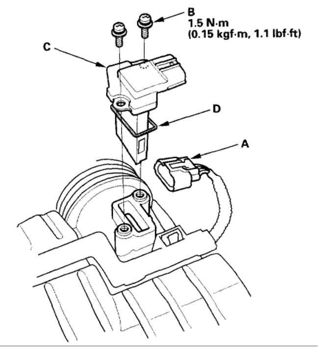

I have the car listed above it is the CVT model. When car is "N" engine speed keeps on fluctuations from 900 to 2000 rpm without A/C , same happens with A/C and also while driving. Engine scan does not show any error. They have cleaned throttle body , 10 % improvement only. If one applies the brakes fluctuations starts immediately. Unable to diagnose issue.
Please help thanks

This sounds more like a MAF problem. When the sensor wires gets dirty is will give the computer a false reading but not enough to create a trouble code. I would try cleaning the sensor first and if that does not work you will need to replace it. Diagram (below).
https://www.2carpros.com/articles/mass-air-flow-service
and
https://www.2carpros.com/articles/how-to-replace-a-mass-air-flow-sensor-maf
I would check the engine for vacuum leaks as well.
Please let us know what happens so it will help others.

Thanks , I had given my car to honda service center, they did scan but no errors , they removed throttle body and cleaned , problem remains, they are saying issues is with CVT gear box which needs to be overhauled and cost is Rs 60000 which is quite expensive , unable to understand role of CVT in engine ideale speed. When you brake car rpm shoots up

Yes that can do it becasue the transmission grabs and releases I hear those CVT transmission are problems and it explains the idle fluctuation.
