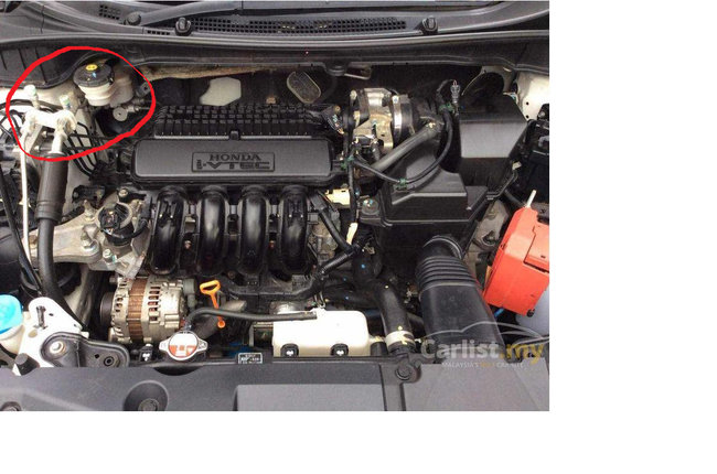

When I took the video, I turned on and off the A/C but the noise is still the same. And at around, 0:25, I can hear a low blowing noise from the left part of the engine. (I attached a photo). And every startup of the car, that encircled part of the photo (where the blowing noise comes from) it makes a loud blowing noise. Is that normal? because I haven't heard it before. Thank you

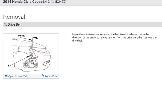

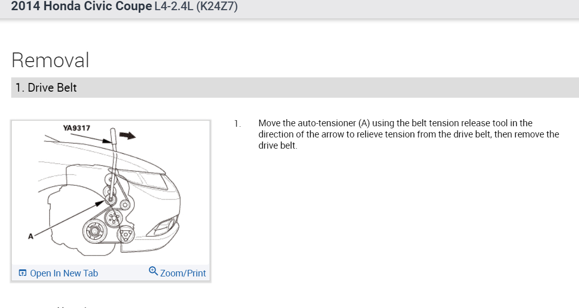

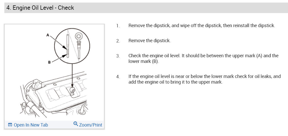

Thanks for the video it helps. it sounds like the camshaft actuator is making noise. can I ask if the engine oil is clean good level and the correct weight oil? To be sure we can remove the serpentine belt to see if the noise goes away. This guide will help walk you through with a diagram below to show you on your car:

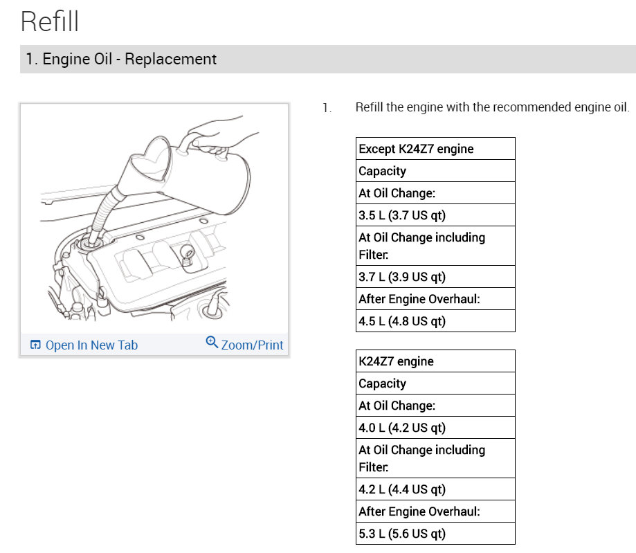

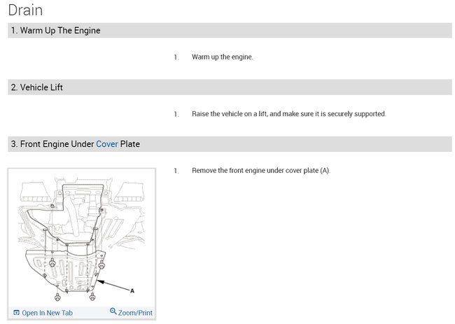

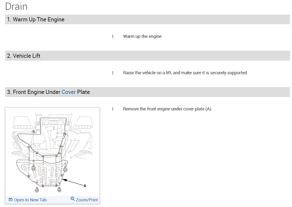

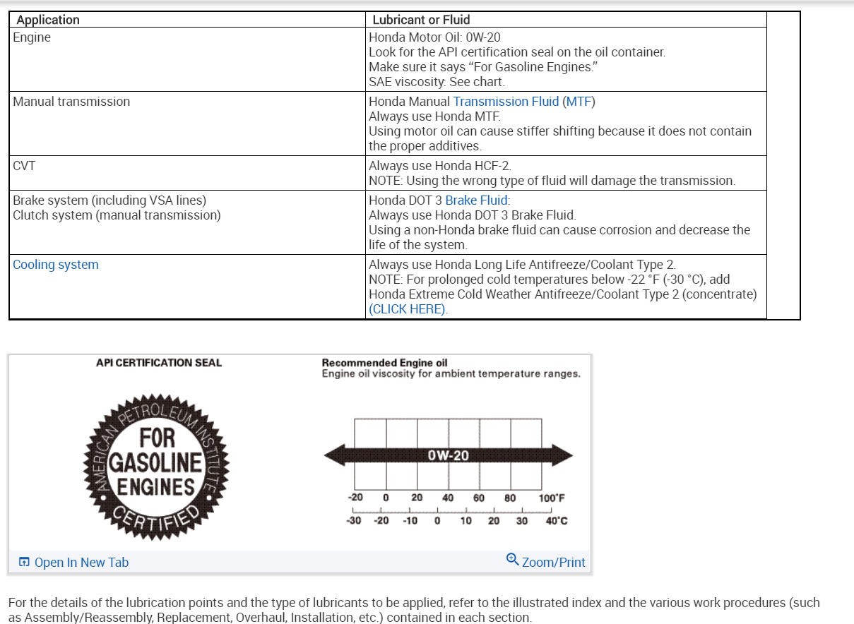

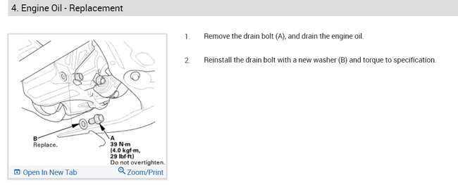

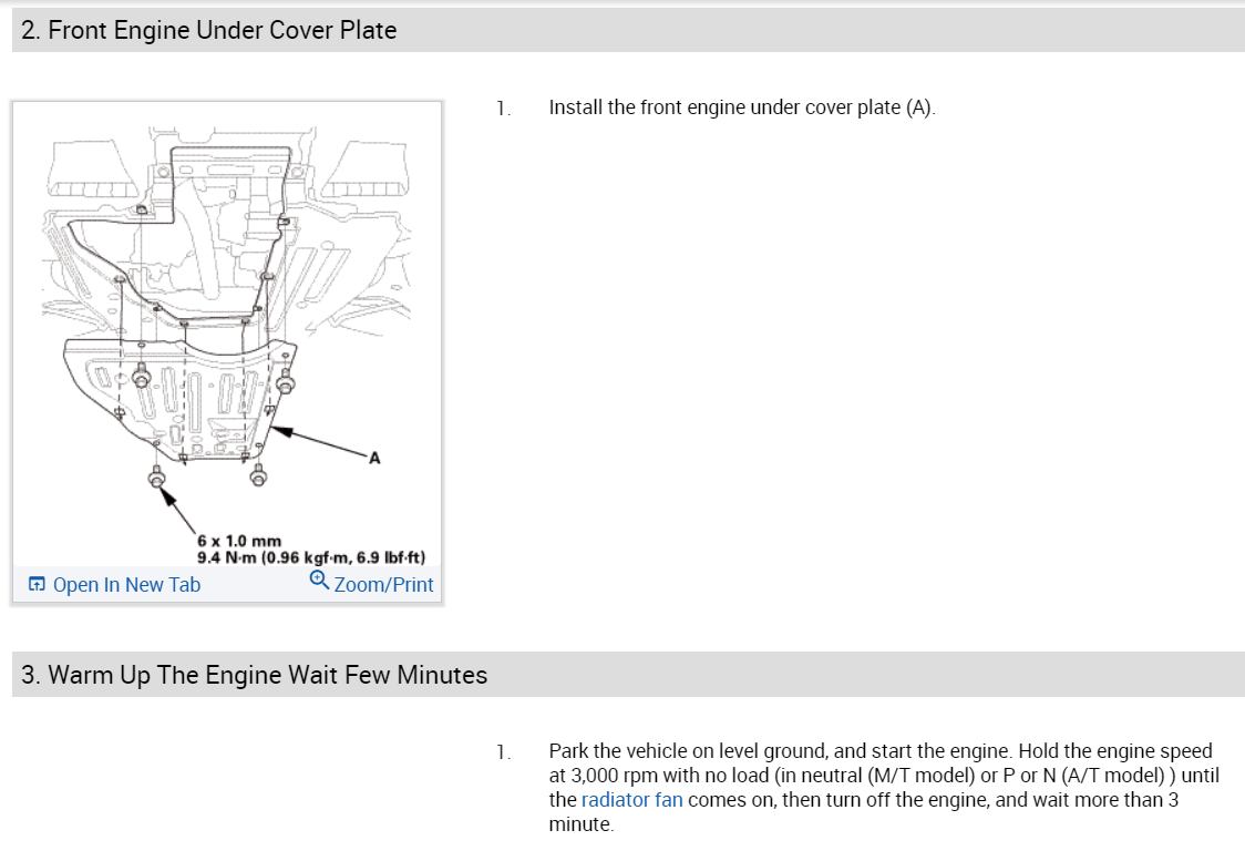

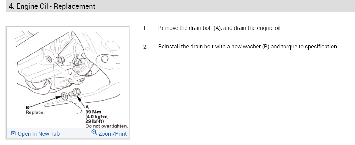

I would change the oil to the manufacturer's recommendation (0w-20) which is below I have also included a guide to help walk you through the steps.
https://www.2carpros.com/articles/how-to-change-engine-oil-and-filter
Check out the diagrams (below). Please let us know what you find. We are interested to see what it is. If you are not doing the job yourself try to watch to make sure they change the oil and filter.

I printed off the enclosed files you sent me. I gave it to the mechanic. They adjusted the "valve setting" in the camshaft, they changed the oil, oil filter and air filter. They changed the serpentine belt (the previous one was just two months old). And so far, no more noise upon start up. and while using the car the whole day, less chirping noise. The mechanic told me that the "chirping noise" is quite normal for some Honda cars.
