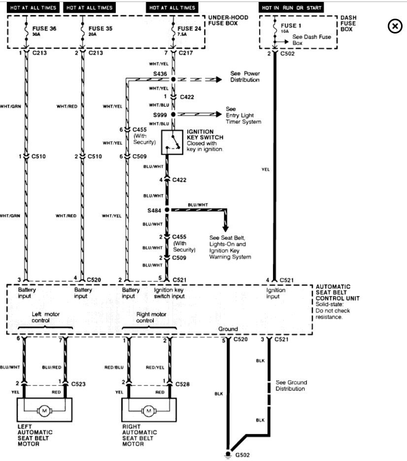

The seat belt light is going off but the seat belt is properly locked into position and the automatic seat belt is all the way back where it is supposed to be. Any suggestions on either turning it off or any easy affordable fix would be great. Thanks!!!

Yes it stays on, or blinks off and on and beeps off and on also.

ok.. then should be a microswitch (switch) thet senses the belt on position.. that could be located at the end of the belt racer.. check that first that should be a double switch because have to take care of stoping the motor that moves the belt...

There is a automatic seat belt warning module that goes out in these cars which makes the chime go off.
Here is a wiring diagram so you can see if you unplug it the chine should stop. Then run some tests to make sure the module is getting signal the belt is in place if it is the module is bad, you should replace it to be safe. There are some fuses that need to be checked as well.
Here is a guide and a diagram to help you get started.
and
and
Please run some tests and get back to us so we can continue helping you.
